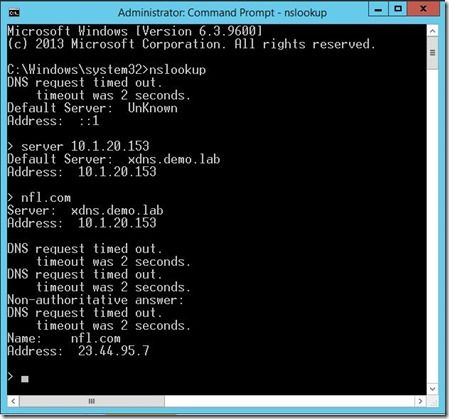

Quite some time ago I was asked about a 2-second delay when performing recursive lookups against the BIG-IP. My first thought was that there was an issue with transport. I then decided to deploy it in my own lab. To my surprise, I was experiencing the exact same issue though I know there were no transport problems in my own environment.
So to give a little more color to the use case at hand, my Windows domain controller is performing recursive lookups against my BIG-IP. My BIG-IP is configured as a recursive DNS server using a transparent cache. This simply means that I am forwarding the request to another upstream DNS server and caching its response. Pretty simple right? Well, there is a little more to it as we will get into.

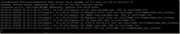

My next step was to look at the DNS query to see what it looked like at the BIG-IP. After a quick search on DevCentral for an iRule to log it, I applied it to my DNS listener and tailed the log.
when DNS_REQUEST {
 log local0. "my question name: [DNS::question name]"
Interesting enough I found that the DNS query from the DC was actually appending the DNS suffix using its actual domain name. Then I also ran a tcpdump from the BIG-IP to see the actual request which indeed confirmed the results of my logs.

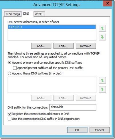

I then logged into my DC to identify the network connection settings. Everything looked OK but I am of course no expert at Windows network settings. As far as I know, this is how every DC is configured by default as I have not modified any of these settings.

  • if you don't want domain appended, you must end the request with a dot.
    nslookup www.google.com
    will first request with domain appended, then fallback to initial request
    nslookup www.google.com.
    will request only
  • Agreed and to be completely transparent, this article was really derived from a customers request that the user experience was not the same when performing manual lookups against the BIG-IP as it was when performing lookups against other name resolution providers. I can't say with 100% certainty though I believe they were only referring to AD which I agreed with them does not require a following . when performing a nslookup. Either way, if a customer feels there is a problem whether there is or isn't they have a solution. The basic iRule also provides some with an example of how to modify DNS queries if a particular suffix is matched. I appreciate the response Stanislas!
