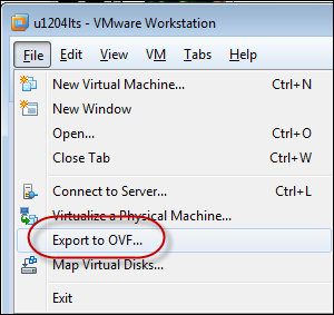

The download for the VM is in OVA format, but the Bluelock virtual datacenters we're deployed in require an OVF template for upload. You can use VMware's ovftool for this, or if you have Workstation, you can just open the OVA in your Workstation app and then select that VM and export to OVF.

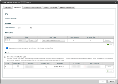

Now that the VM is in the proper form for my environment, I can upload "To the Cloud!" (sorry, couldn't resist) to the virtual datacenter and build the VM. The OVF template should take care of your cpu, memory, and disk allocations, but if the cpu and memory are blank, you can just set to 1 cpu and 1G of RAM as shown in the hardware properties below.

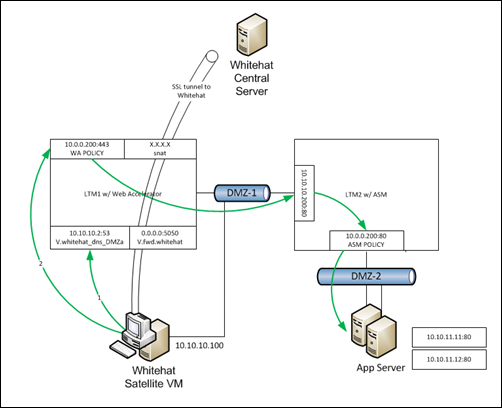

I wrote a blog last week about the DNS challenge presented with this solution, so I won't rehash that here, but you can see in the drawing below that step 1 for the scanner is to do a DNS lookup of the host. A virtual server has an iRule attached to provide a single response to queries from the Sentinel satellite, and then the rest of the app infrastructure is already in place for scanning.
The only part left to handle is the communication between the satellite and WhiteHat. The support/operations teams within WhiteHat need to be able to control and report from the satellite, so I configured a virtual server that forwards on the required tcp port 5050 and snat the source to our external IP addresses. Immediately after activating that configuration the satellite synced up with WhiteHat's server and we were good to go.
