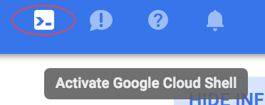

In order to use Helm, it needs to be installed into the virtual machine running the Google Cloud Shell.
Copy and paste the following commands into the Google Cloud Shell. First, get a copy of the Helm software.

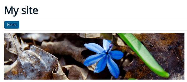

Copy and paste the URL into a browser. You will need the credentials which can be found by copying and pasting the below commands into the Google Cloud Shell.
 echo Username: user
 echo Password: $(kubectl get secret --namespace default my-joomla-joomla -o jsonpath="{.data.joomla-password}" | base64 --decode)
Enter the credentials into the web page. You are now the administrator. Feel free to explore the Joomla application you deployed. When finished, let’s clean up.

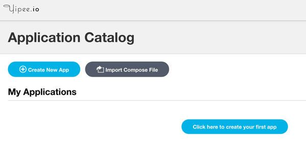

Now that you have an account at Yipee.io, navigate to the Application Catalog.

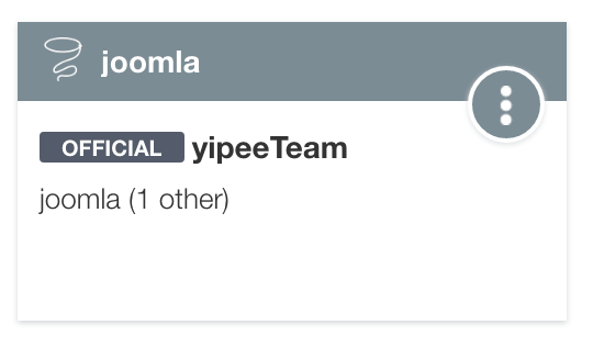

Notice that you have several options, including creating your first app. Instead, let’s explore a public app that has already been defined. Click on the title of the Joomla app.

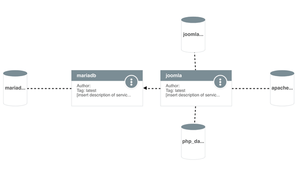

Here you will see the diagram of the Joomla application, containing two containers and four storage volumes.

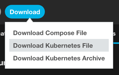

If you wanted to make changes, you could copy to your own workspace and then edit the deployment. We will deploy it as defined. Download the configuration as a Kubernetes file.
 echo Username: user
 echo Password: bitnami
Enter the credentials into the web page. You are now the administrator. Feel free to explore the Joomla application you deployed. When finished, let’s clean up with one command.
