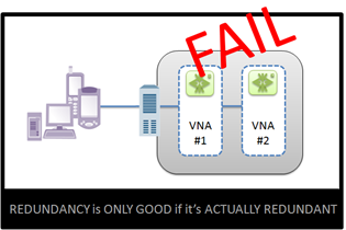

Thus, the definition of reliability as it pertains to our new, agile and cloud-based applications is directly related to the longest time required to either replace or provision any comprised component. Single points of failure, you see, are very bad for reliability. Especially when they are virtualized and it may the case that there are no resources available that can be used to “replace” the failed component. This is particularly important to note as we start to virtualize the infrastructure. It sounds like a good deal: virtual network appliances dramatically decrease the CapEx associated with such investments, but operationally you still have the same challenges to address. You still need a redundant system and they must reside on physically separate systems, in case the hardware upon which the virtual network appliance is deployed itself fails. That’s true as well for applications; redundancy must be system-wide which means two instances of the same application on the same physical device invites unreliability.
And when you realize that you’re going to need a physical system for every instance of a virtual network appliance, you might start wondering why it was that you virtualized them in the first place. Especially when you consider you exchanged nearly instantaneous serial-based fail-over for pretty fast network-based failure and a largely reduced capacity per instance. And of course any gains provided by purpose-built hardware acceleration that cannot easily (or cheaply) be duplicated in a virtualized environment. Oh, and let’s not forget the potential of creating a single point of failure where there was none by eliminating the fail-to-wire option of so many infrastructure components. Almost every proxy-based network component “fails to wire” in the event of a failure resulting in a loss of functionality but not the ability to pass data, which means availability of the application is not compromised in the event a failure, although security or other functionality might be.Yes, you gained architectural multi-tenancy and simplified provisioning, but the need for such an implementation is quickly being erased by the rush by vendors to provide true multi-tenancy for network-based infrastructure and many of the gains in provisioning can be achieved using the same infrastructure 2.0 capable methods (APIs, SDKs) that are used to integrate virtual form factors.
