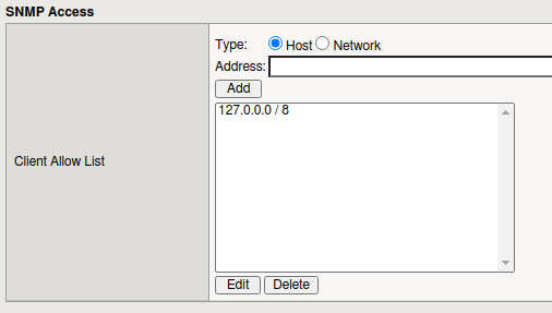

- rebar_ali
It would be a great script if I can make it work. It through "Error-Failure to run snmpwalk"!
- Leonardo_Souza
Cirrocumulus
You probably customised the allow list for SNMP.
You need to add localhost, 172.0.0.0/8 to the list.
This is the default the system comes with:
- rebar_ali
Yep, it works like a charm. Thank you so much Leonardo!
