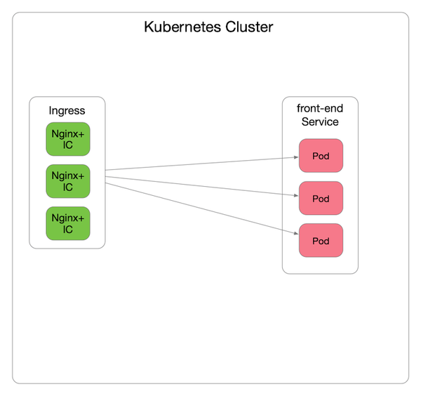

Introduction
The F5 Container Ingress Services (CIS) can be integrated with the NGINX Plus Ingress Controllers (NIC) within a Kubernetes (k8s) environment.
The benefits are getting the best of both worlds, with the BIG-IP providing comprehensive L4 ~ L7 security services, while leveraging NGINX Plus as the de facto standard for micro services solution.

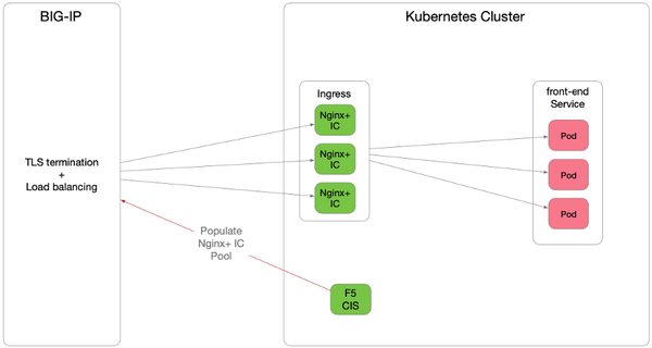

This architecture is depicted below.
The integration is made fluid via the CIS, a k8s pod that listens to events in the cluster and dynamically populates the BIG-IP pool pointing to the NIC's as they scale.
There are a few components need to be stitched together to support this integration, each of which is discussed in detail over the proceeding sections.

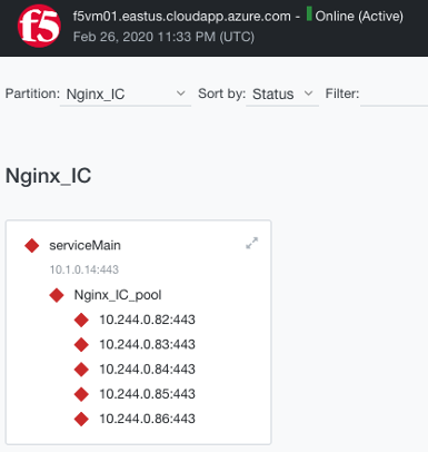

On the BIG-IP, the following should be created.
The end product is below.

--manage-ingress=false
--insecure=true
--as3-validation=true
--node-poll-interval=30
--verify-interval=30
--log-level=INFO
State: Running
Started: Mon, 08 Jun 2020 20:40:20 +0000
Ready: True
Restart Count: 0
Environment:
BIGIP_USERNAME: <set to the key 'username' in secret 'bigip-login'> Optional: false
BIGIP_PASSWORD: <set to the key 'password' in secret 'bigip-login'> Optional: false
Mounts:
/var/run/secrets/kubernetes.io/serviceaccount from bigip-ctlr-token-r6rvn (ro)
Conditions:
Type Status
Initialized True
Ready True
ContainersReady True
PodScheduled True
Volumes:
bigip-ctlr-token-r6rvn:
Type: Secret (a volume populated by a Secret)
SecretName: bigip-ctlr-token-r6rvn
Optional: false
QoS Class: BestEffort
Node-Selectors: <none>
Tolerations: node.kubernetes.io/not-ready:NoExecute for 300s
node.kubernetes.io/unreachable:NoExecute for 300s
Events:
Type Reason Age From Message
Normal Scheduled <unknown> default-scheduler Successfully assigned kube-system/k8s-bigip-ctlr-deployment-6759c46587-tdk79 to worker-2
Normal Pulling 17m kubelet, worker-2 Pulling image "f5networks/k8s-bigip-ctlr:1.14.0"
Normal Pulled 17m kubelet, worker-2 Successfully pulled image "f5networks/k8s-bigip-ctlr:1.14.0"
Normal Created 17m kubelet, worker-2 Created container k8s-bigip-ctlr
Normal Started 17m kubelet, worker-2 Started container k8s-bigip-ctlr
Any help is greatly appreciated.
Thanks
Kunal
