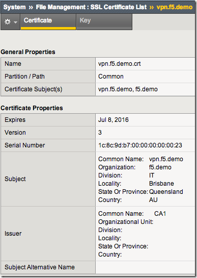

1.1 Import the SSL Certificate/Key that will be used for SSL VPN connection
System >> File Management >> SSL Certificate List
Please follow SOL14620: Managing SSL certificates for BIG-IP systems
My configuration looks like this:

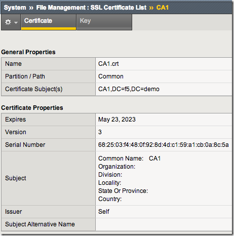

1.2 Import Certificate Authority Certificate that is signing the Client Certificates
Repeat Step 1.1 but this time you need to import the CA Certificate (without the Key) that is signing the User Certificates. It should look something similar to this:

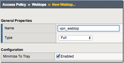

3.1 Create a Webtop
Access Policy >> Webtop >> Webtop List >> “Create”
Supply the following:
- Name: vpn_webtop
- Type: Full
Select “Finished” to save.

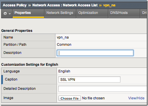

3.4 Create a Network Access
Access Policy >> Network Access >> Network Access List >> “Create”
- Name: vpn_na
- Caption: SSL VPN
Select “Update” to save.

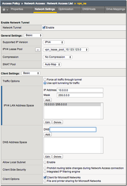

Under “Network Settings”.
- IPV4 Lease Pool: vpn_lease_pool_10.123.123.0
- Traffic Options: Use split tunneling for traffic (select appropriate option for your environment)
- IP Address: 10.0.0.0
- Mask: 255.0.0.0
- Select “Add”

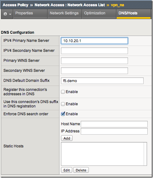

Under “DNS/Hosts”
- IPV4 Primary Name Server: 10.10.20.1
- DNS Default Domain Suffix: f5.demo

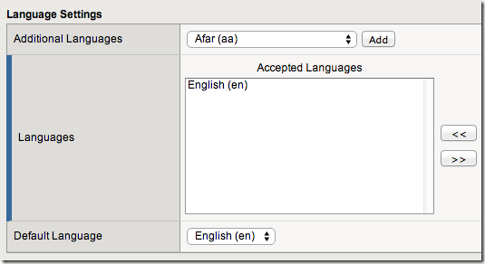

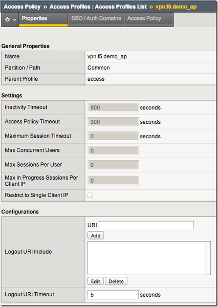

Access Policy >> Access Profiles >> Access Profile List >> “Create”
- Name: vpn.f5.demo_ap
- Languages: English (en)
- Use the default settings for all other settings.

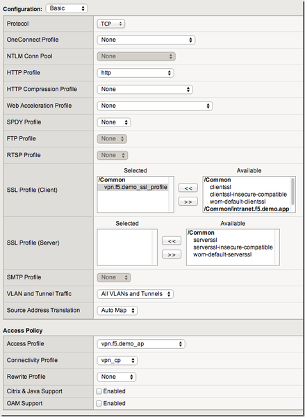

Step 4 – Create the Virtual Server for SSL VPN

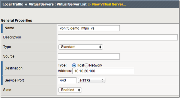

In this step, you need to create a HTTPS Virtual Server (VS) for the Edge Client to establish the connection. I also recommend creating a DTLS VS in addition to the HTTPS VS. This configuration is well documented in the APM Manual and I will not go through the DTLS VS creation.
4.1 Create the HTTP VS
Local Traffic >> Virtual Servers >> Virtual Server List >> “Create”
- Name: vpn.f5.demo_https_vs
- Destination: 10.10.20.100
- Service Port: HTTPS
- HTTP Profile: http
- SSL Profile (Client): vpn.f5.demo_ssl_profile (from step 2)
- SNAT Pool: Auto Map
- Access Profile: vpn.f5.demo_ap (from step 3.5)
- Connectivity Profile: vpn_cp (from step 3.2)
Select “Finished" to save.

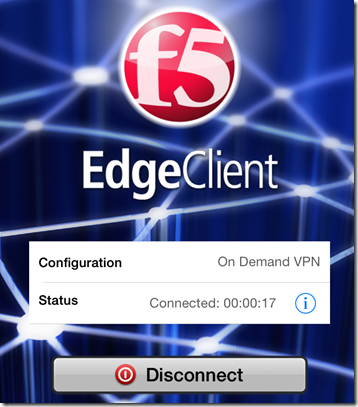

Step 5 – Configure the Edge Client on the iOS device and Test
5.1 Create a new Edge Client Configuration
- Open the Edge Client and select “Settings” then “Add Configuration…”
- Supply the following:
- Description: On Demand VPN
- Server: vpn.f5.demo
- Use Certificate: On
- Certificate: Test User

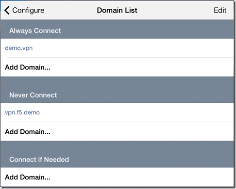

- Connect On Demand: On
- Select Domain List
- Add Domain…
- In my example: demo.vpn
- Don’t forget to Save

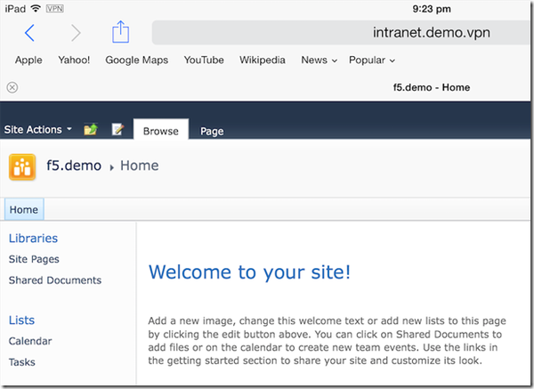

5.2 Test
Open Safari and access a URL that will cause the VPN trigger. In my example http://intranet.demo.vpn, a Sharepoint site. The VPN will start up when it sees the DNS query for intranet.demo.vpn and the data will flow across the VPN as per the Network Access settings.
Conclusion
On-Demand VPN with APM is a simple way to enable the workforce by providing a secure and easy to use remote access solution while out of the office.

On the APM side, you would need to change the Inactivity Timeout: If there is no activity (defined by the Session Update Threshold and Session Update Window settings in the Network Access configuration) between the client and server within the specified threshold time, the system closes the current session. By default, the timeout is 900 seconds. However, if an inactivity timeout value is set, when server traffic exceeds the specified threshold, the inactivity timeout is reset. To disable the inactivity timeout, set the Inactivity Timeout to 0.
