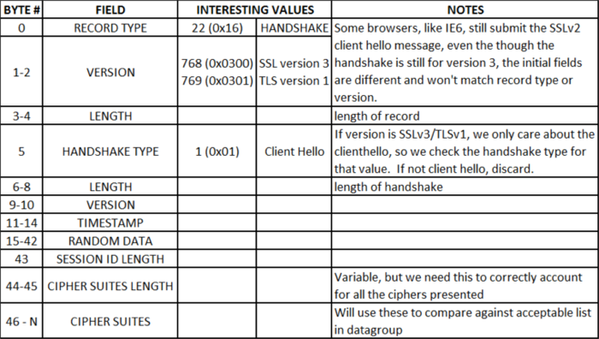

Before you can start mapping fields, you need to know where the delimiters are, and that takes a little research. In this example, I want to list out the cipher suites presented to the BIG-IP LTM by the browser (more on that later), so I’m going to decode the fields in an SSLv3/TLSv1 client hello message. I took a capture with Wireshark to find the field delineations, but you could also pull this information from RFC 2246 if you are so inclined. The table below shows the fields I’ll extract or skip over in the course of the iRule code.
So why do I want to look at the cipher suites? I was contacted by a friend who wanted to increase security to 256-bit ciphers for those browsers that supported it, but would still allow users that don’t to connect as well so they could be redirected to an error page requesting they upgrade. With the cipher settings as they were, the unsupported browser (in this case, IE6) could connect, but the newer browsers connected at 128-bit as well instead of 256-bit. I later learned (courtesy of none other than hoolio) that I could use @STRENGTH in my cipher settings to force the capable browsers up, but for the benefit of demonstrating the use the binary string command, I’ll proceed with the iRule.

As shown in the binary scan syntax, “c” grabs one byte and returns a signed integer, and “S” grabs two-bytes and returns a signed integer. The rest of the payload is thrown away. From table 1, we know the first three fields of SSLv3/TLSv1 client hello’s are one-byte, two-byte, two-byte, so a format string of cSS followed by three variable names takes care of the parsing. The clientssl profile doesn’t yet support TLS 1.1 or 1.2, so I’m only testing for SSLv3/TLSv1. The SSLv2 and earlier record format is different altogether, so the initial fields wouldn’t map this way anyway. This is true of IE6, which by default issues a SSLv2 client hello but supports SSLv3/TLSv1. Confused yet? Anyway, once the test for SSLv3/TLSv1 is complete, I then make sure the record type is a client hello, if not, no reason to continue.
Once the verification is complete that this really is a client hello, there is a string (pun intended!) of binary scans to sort the rest of the details out:

I’m using the “@” symbol to skip bytes in the binary string. Also, the curly brackets are necessary to surround the variable name to distinguish your variable from the significance of the format string characters. In the first binary scan above, I’m skipping the record header and all the random data as I don’t need that information, but I do need the session ID length so I can set my offset properly to get to the cipher list. In the second binary scan, again I’m skipping (from original payload) the new offset and then storing another two-byte signed integer that tells me how long the cipher list is. From that information, I set a new offset, set the cipher list length (number of ciphers * 2, each cipher is two-bytes) and then perform the final binary scan to store the entire cipher list (in hex high->low characters, hence the “H” in the string format).
