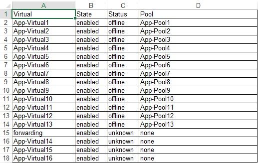

Problem this snippet solves:
The below is a simple code to get a report on Virtuals present in the BigIP, with its name, state, status and the pool name associated to it.
Should be helpful in building reports for management or auditing. The output can be seen in console (if needed) or can be written to a file with csv format, so when opened in excel it would look like below snapshot.
The output file will be save in
/var/tmp/virtual_stats-output.csv
How to use this snippet:
In the console,
tmsh
create cli script virtual_stats
and paste the below code and save.
Code :
