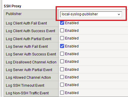

Next you need to have a logging profile configured with these settings:
It is important you have that particular publisher set as it is sending the failures to the ltm log. You should be aware of the limitations of logging locally before you make use of this solution. If it is a very busy unit the disk might not be happy with some extra writing. In a perfect world you could log these failures to a remote logging server, but then you need to have the counting logic running elsewhere and have the script use the API to ingest the IPs. Or make use of a IP Intelligence feed which can load the IPs from a webserver. This is however out of scope for this solution, but I might make a follow up article on this if time allows it.
