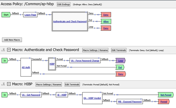

Configuring the Visual Policy Editor
The printscreen below is an example Visual Policy Editor on how you can use the Pnwed Password snippet.
VA – Force Password Change
This is a Variable Assignment agent that triggers APM to show a Change Password window. Set variable:
session.logon.last.change_password to Custom Expression: expr { 1 }
VA – Get Password
This is a Variable Assignment agent that copies the password to a session variable that can be read by the hibp irule. Set variable:
session.custom.hibp.password to Custom Expression: return [mcget -secure {session.logon.last.password}]
IE - HIBP
This is an irule event with the ID set to ‘hibp’. This will trigger the hibp_irule to come into action.
EA – HIBP Verdict
This is an Empty Action with two branches. The branch named "Not Pwned" contains the following expression :
expr { [mcget -nocache {session.custom.hibp.status} ] == 0 }
MB – Exposed Password
This is a message box that will inform the user that it’s password was exposed in earlier data breaches and a password change is needed. The message could be something like this:
The password you are using was found in %{session.custom.hibp.status} data breaches. In order to be compliant with our security policy, you must change your password.

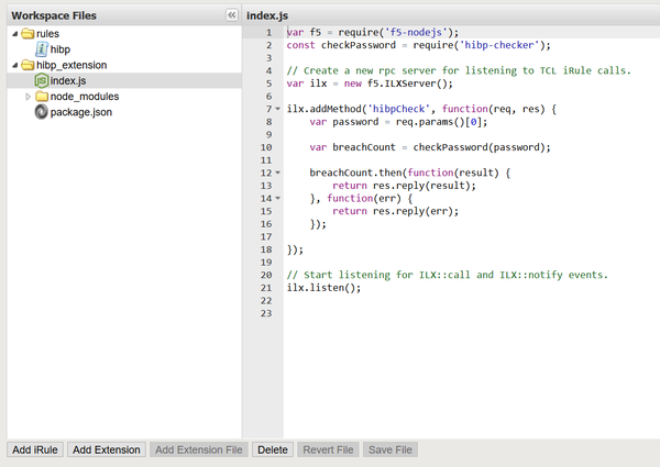

var f5 = require('f5-nodejs');
const checkPassword = require('hibp-checker');
// Create a new rpc server for listening to TCL iRule calls.
var ilx = new f5.ILXServer();
ilx.addMethod('hibpCheck', function(req, res) {
var password = req.params()[0];
var breachCount = checkPassword(password);
breachCount.then(function(result) {
return res.reply(result);
}, function(err) {
return res.reply(err);
// Start listening for ILX::call and ILX::notify events.
ilx.listen();Tested this on version:

Second, the code piece (the actual iRuleLX) goes into the "index.js" in the tree like this:

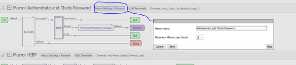

And last but not least in the VPE you need to edit the macro settings of "Authenticate and Check Password" to allow at least 2 loops otherwise the variable assignment "session.logon.last.change_password" doesn't initiate a change password process and just fails (ends up in deny). Also the "loop" ending isn't available to you when you build it before this is adjusted. This is what it looks like:
Hopefully others will be spared the tedious hours of banging your head against the wall of malfunction, thus this cartoon post :-)
