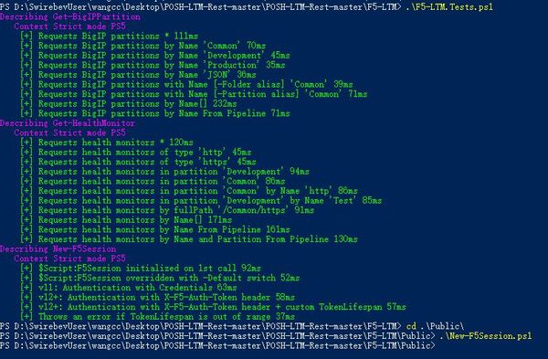

There is a function called Test-Functionality that takes an F5Session object, a new pool name, a new virtual server, an IP address for the virtual server, and a computer name as a pool member, and validates nearly all the functions in the module.
\n
I've also contributed this code sample for how to gather some basic info about your LTM with this PS module.
\n
The module has been tested on:
\n
11.5.1 Build 8.0.175 Hotfix 8 and later
11.6.0 Build 5.0.429 Hotfix 4 and later
12.0 / 12.1
13.0
Code :
https://github.com/joel74/POSH-LTM-Rest
Tested this on version:
11.5","kudosSumWeight":3,"postTime":"2015-12-04T06:53:10.000-08:00","images":{"__typename":"AssociatedImageConnection","edges":[],"totalCount":0,"pageInfo":{"__typename":"PageInfo","hasNextPage":false,"endCursor":null,"hasPreviousPage":false,"startCursor":null}},"attachments":{"__typename":"AttachmentConnection","pageInfo":{"__typename":"PageInfo","hasNextPage":false,"endCursor":null,"hasPreviousPage":false,"startCursor":null},"edges":[]},"tags":{"__typename":"TagConnection","pageInfo":{"__typename":"PageInfo","hasNextPage":false,"endCursor":null,"hasPreviousPage":false,"startCursor":null},"edges":[{"__typename":"TagEdge","cursor":"MjUuMnwyLjF8b3wxMHxfTlZffDE","node":{"__typename":"Tag","id":"tag:devops","text":"devops","time":"2011-10-19T17:50:55.000-07:00","lastActivityTime":null,"messagesCount":null,"followersCount":null}},{"__typename":"TagEdge","cursor":"MjUuMnwyLjF8b3wxMHxfTlZffDI","node":{"__typename":"Tag","id":"tag:iControlREST","text":"iControlREST","time":"2022-01-24T02:29:46.488-08:00","lastActivityTime":null,"messagesCount":null,"followersCount":null}},{"__typename":"TagEdge","cursor":"MjUuMnwyLjF8b3wxMHxfTlZffDM","node":{"__typename":"Tag","id":"tag:LTM","text":"LTM","time":"2022-01-24T02:29:45.119-08:00","lastActivityTime":null,"messagesCount":null,"followersCount":null}},{"__typename":"TagEdge","cursor":"MjUuMnwyLjF8b3wxMHxfTlZffDQ","node":{"__typename":"Tag","id":"tag:microsoft powershell with icontrol","text":"microsoft powershell with icontrol","time":"2022-01-24T02:29:45.066-08:00","lastActivityTime":null,"messagesCount":null,"followersCount":null}},{"__typename":"TagEdge","cursor":"MjUuMnwyLjF8b3wxMHxfTlZffDU","node":{"__typename":"Tag","id":"tag:powershell","text":"powershell","time":"2022-01-24T02:30:05.731-08:00","lastActivityTime":null,"messagesCount":null,"followersCount":null}}]},"timeToRead":3,"rawTeaser":"","introduction":"","currentRevision":{"__ref":"Revision:revision:282980_2"},"latestVersion":{"__typename":"FriendlyVersion","major":"2","minor":"0"},"metrics":{"__typename":"MessageMetrics","views":20015},"visibilityScope":"PUBLIC","canonicalUrl":null,"seoTitle":null,"seoDescription":null,"placeholder":false,"originalMessageForPlaceholder":null,"contributors":{"__typename":"UserConnection","edges":[]},"nonCoAuthorContributors":{"__typename":"UserConnection","edges":[]},"coAuthors":{"__typename":"UserConnection","edges":[]},"tkbMessagePolicies":{"__typename":"TkbMessagePolicies","canDoAuthoringActionsOnTkb":{"__typename":"PolicyResult","failureReason":{"__typename":"FailureReason","message":"error.lithium.policies.tkb.policy_can_do_authoring_action.accessDenied","key":"error.lithium.policies.tkb.policy_can_do_authoring_action.accessDenied","args":[]}}},"archivalData":null,"replies":{"__typename":"MessageConnection","edges":[{"__typename":"MessageEdge","cursor":"MjUuMnwyLjF8aXwxMHwzOTowfGludCwzMzExNTEsMzMxMTUx","node":{"__ref":"TkbReplyMessage:message:331151"}},{"__typename":"MessageEdge","cursor":"MjUuMnwyLjF8aXwxMHwzOTowfGludCwzMzExNTEsMjk5NzM0","node":{"__ref":"TkbReplyMessage:message:299734"}},{"__typename":"MessageEdge","cursor":"MjUuMnwyLjF8aXwxMHwzOTowfGludCwzMzExNTEsMjk5MzQ3","node":{"__ref":"TkbReplyMessage:message:299347"}},{"__typename":"MessageEdge","cursor":"MjUuMnwyLjF8aXwxMHwzOTowfGludCwzMzExNTEsMjgzMTI3","node":{"__ref":"TkbReplyMessage:message:283127"}},{"__typename":"MessageEdge","cursor":"MjUuMnwyLjF8aXwxMHwzOTowfGludCwzMzExNTEsMjgzMTI2","node":{"__ref":"TkbReplyMessage:message:283126"}},{"__typename":"MessageEdge","cursor":"MjUuMnwyLjF8aXwxMHwzOTowfGludCwzMzExNTEsMjgzMTI1","node":{"__ref":"TkbReplyMessage:message:283125"}},{"__typename":"MessageEdge","cursor":"MjUuMnwyLjF8aXwxMHwzOTowfGludCwzMzExNTEsMjgzMTI0","node":{"__ref":"TkbReplyMessage:message:283124"}},{"__typename":"MessageEdge","cursor":"MjUuMnwyLjF8aXwxMHwzOTowfGludCwzMzExNTEsMjgzMTIz","node":{"__ref":"TkbReplyMessage:message:283123"}},{"__typename":"MessageEdge","cursor":"MjUuMnwyLjF8aXwxMHwzOTowfGludCwzMzExNTEsMjgzMTIy","node":{"__ref":"TkbReplyMessage:message:283122"}},{"__typename":"MessageEdge","cursor":"MjUuMnwyLjF8aXwxMHwzOTowfGludCwzMzExNTEsMjgzMTIx","node":{"__ref":"TkbReplyMessage:message:283121"}}],"pageInfo":{"__typename":"PageInfo","hasNextPage":true,"endCursor":"MjUuMnwyLjF8aXwxMHwzOTowfGludCwzMzExNTEsMjgzMTIx","hasPreviousPage":false,"startCursor":null}},"customFields":[],"revisions({\"constraints\":{\"isPublished\":{\"eq\":true}},\"first\":1})":{"__typename":"RevisionConnection","totalCount":2}},"Conversation:conversation:282980":{"__typename":"Conversation","id":"conversation:282980","solved":false,"topic":{"__ref":"TkbTopicMessage:message:282980"},"lastPostingActivityTime":"2024-07-01T03:22:52.096-07:00","lastPostTime":"2024-07-01T03:22:52.096-07:00","unreadReplyCount":150,"isSubscribed":false},"ModerationData:moderation_data:282980":{"__typename":"ModerationData","id":"moderation_data:282980","status":"APPROVED","rejectReason":null,"isReportedAbuse":false,"rejectUser":null,"rejectTime":null,"rejectActorType":null},"Revision:revision:282980_2":{"__typename":"Revision","id":"revision:282980_2","lastEditTime":"2023-06-05T22:21:20.139-07:00"},"CachedAsset:theme:customTheme1-1743756125333":{"__typename":"CachedAsset","id":"theme:customTheme1-1743756125333","value":{"id":"customTheme1","animation":{"fast":"150ms","normal":"250ms","slow":"500ms","slowest":"750ms","function":"cubic-bezier(0.07, 0.91, 0.51, 1)","__typename":"AnimationThemeSettings"},"avatar":{"borderRadius":"50%","collections":["custom"],"__typename":"AvatarThemeSettings"},"basics":{"browserIcon":{"imageAssetName":"JimmyPackets-512-1702592938213.png","imageLastModified":"1702592945815","__typename":"ThemeAsset"},"customerLogo":{"imageAssetName":"f5_logo_fix-1704824537976.svg","imageLastModified":"1704824540697","__typename":"ThemeAsset"},"maximumWidthOfPageContent":"1600px","oneColumnNarrowWidth":"800px","gridGutterWidthMd":"30px","gridGutterWidthXs":"10px","pageWidthStyle":"WIDTH_OF_PAGE_CONTENT","__typename":"BasicsThemeSettings"},"buttons":{"borderRadiusSm":"5px","borderRadius":"5px","borderRadiusLg":"5px","paddingY":"5px","paddingYLg":"7px","paddingYHero":"var(--lia-bs-btn-padding-y-lg)","paddingX":"12px","paddingXLg":"14px","paddingXHero":"42px","fontStyle":"NORMAL","fontWeight":"400","textTransform":"NONE","disabledOpacity":0.5,"primaryTextColor":"var(--lia-bs-white)","primaryTextHoverColor":"var(--lia-bs-white)","primaryTextActiveColor":"var(--lia-bs-white)","primaryBgColor":"var(--lia-bs-primary)","primaryBgHoverColor":"hsl(var(--lia-bs-primary-h), var(--lia-bs-primary-s), calc(var(--lia-bs-primary-l) * 0.85))","primaryBgActiveColor":"hsl(var(--lia-bs-primary-h), var(--lia-bs-primary-s), calc(var(--lia-bs-primary-l) * 0.7))","primaryBorder":"1px solid transparent","primaryBorderHover":"1px solid transparent","primaryBorderActive":"1px solid transparent","primaryBorderFocus":"1px solid var(--lia-bs-white)","primaryBoxShadowFocus":"0 0 0 1px var(--lia-bs-primary), 0 0 0 4px hsla(var(--lia-bs-primary-h), var(--lia-bs-primary-s), var(--lia-bs-primary-l), 0.2)","secondaryTextColor":"var(--lia-bs-gray-900)","secondaryTextHoverColor":"hsl(var(--lia-bs-gray-900-h), var(--lia-bs-gray-900-s), calc(var(--lia-bs-gray-900-l) * 0.95))","secondaryTextActiveColor":"hsl(var(--lia-bs-gray-900-h), var(--lia-bs-gray-900-s), calc(var(--lia-bs-gray-900-l) * 0.9))","secondaryBgColor":"var(--lia-bs-gray-400)","secondaryBgHoverColor":"hsl(var(--lia-bs-gray-400-h), var(--lia-bs-gray-400-s), calc(var(--lia-bs-gray-400-l) * 0.96))","secondaryBgActiveColor":"hsl(var(--lia-bs-gray-400-h), var(--lia-bs-gray-400-s), calc(var(--lia-bs-gray-400-l) * 0.92))","secondaryBorder":"1px solid transparent","secondaryBorderHover":"1px solid transparent","secondaryBorderActive":"1px solid transparent","secondaryBorderFocus":"1px solid transparent","secondaryBoxShadowFocus":"0 0 0 1px var(--lia-bs-primary), 0 0 0 4px hsla(var(--lia-bs-primary-h), var(--lia-bs-primary-s), var(--lia-bs-primary-l), 0.2)","tertiaryTextColor":"var(--lia-bs-gray-900)","tertiaryTextHoverColor":"hsl(var(--lia-bs-gray-900-h), var(--lia-bs-gray-900-s), calc(var(--lia-bs-gray-900-l) * 0.95))","tertiaryTextActiveColor":"hsl(var(--lia-bs-gray-900-h), var(--lia-bs-gray-900-s), calc(var(--lia-bs-gray-900-l) * 0.9))","tertiaryBgColor":"transparent","tertiaryBgHoverColor":"transparent","tertiaryBgActiveColor":"hsla(var(--lia-bs-black-h), var(--lia-bs-black-s), var(--lia-bs-black-l), 0.04)","tertiaryBorder":"1px solid transparent","tertiaryBorderHover":"1px solid hsla(var(--lia-bs-black-h), var(--lia-bs-black-s), var(--lia-bs-black-l), 0.08)","tertiaryBorderActive":"1px solid transparent","tertiaryBorderFocus":"1px solid transparent","tertiaryBoxShadowFocus":"0 0 0 1px var(--lia-bs-primary), 0 0 0 4px hsla(var(--lia-bs-primary-h), var(--lia-bs-primary-s), var(--lia-bs-primary-l), 0.2)","destructiveTextColor":"var(--lia-bs-danger)","destructiveTextHoverColor":"hsl(var(--lia-bs-danger-h), var(--lia-bs-danger-s), calc(var(--lia-bs-danger-l) * 0.95))","destructiveTextActiveColor":"hsl(var(--lia-bs-danger-h), var(--lia-bs-danger-s), calc(var(--lia-bs-danger-l) * 0.9))","destructiveBgColor":"var(--lia-bs-gray-300)","destructiveBgHoverColor":"hsl(var(--lia-bs-gray-300-h), var(--lia-bs-gray-300-s), calc(var(--lia-bs-gray-300-l) * 0.96))","destructiveBgActiveColor":"hsl(var(--lia-bs-gray-300-h), var(--lia-bs-gray-300-s), calc(var(--lia-bs-gray-300-l) * 0.92))","destructiveBorder":"1px solid transparent","destructiveBorderHover":"1px solid transparent","destructiveBorderActive":"1px solid transparent","destructiveBorderFocus":"1px solid transparent","destructiveBoxShadowFocus":"0 0 0 1px var(--lia-bs-primary), 0 0 0 4px hsla(var(--lia-bs-primary-h), var(--lia-bs-primary-s), var(--lia-bs-primary-l), 0.2)","__typename":"ButtonsThemeSettings"},"border":{"color":"hsla(var(--lia-bs-black-h), var(--lia-bs-black-s), var(--lia-bs-black-l), 0.08)","mainContent":"NONE","sideContent":"NONE","radiusSm":"3px","radius":"5px","radiusLg":"9px","radius50":"100vw","__typename":"BorderThemeSettings"},"boxShadow":{"xs":"0 0 0 1px hsla(var(--lia-bs-gray-900-h), var(--lia-bs-gray-900-s), var(--lia-bs-gray-900-l), 0.08), 0 3px 0 -1px hsla(var(--lia-bs-gray-900-h), var(--lia-bs-gray-900-s), var(--lia-bs-gray-900-l), 0.08)","sm":"0 2px 4px hsla(var(--lia-bs-gray-900-h), var(--lia-bs-gray-900-s), var(--lia-bs-gray-900-l), 0.06)","md":"0 5px 15px hsla(var(--lia-bs-gray-900-h), var(--lia-bs-gray-900-s), var(--lia-bs-gray-900-l), 0.15)","lg":"0 10px 30px hsla(var(--lia-bs-gray-900-h), var(--lia-bs-gray-900-s), var(--lia-bs-gray-900-l), 0.15)","__typename":"BoxShadowThemeSettings"},"cards":{"bgColor":"var(--lia-panel-bg-color)","borderRadius":"var(--lia-panel-border-radius)","boxShadow":"var(--lia-box-shadow-xs)","__typename":"CardsThemeSettings"},"chip":{"maxWidth":"300px","height":"30px","__typename":"ChipThemeSettings"},"coreTypes":{"defaultMessageLinkColor":"var(--lia-bs-primary)","defaultMessageLinkDecoration":"none","defaultMessageLinkFontStyle":"NORMAL","defaultMessageLinkFontWeight":"400","defaultMessageFontStyle":"NORMAL","defaultMessageFontWeight":"400","forumColor":"#0C5C8D","forumFontFamily":"var(--lia-bs-font-family-base)","forumFontWeight":"var(--lia-default-message-font-weight)","forumLineHeight":"var(--lia-bs-line-height-base)","forumFontStyle":"var(--lia-default-message-font-style)","forumMessageLinkColor":"var(--lia-default-message-link-color)","forumMessageLinkDecoration":"var(--lia-default-message-link-decoration)","forumMessageLinkFontStyle":"var(--lia-default-message-link-font-style)","forumMessageLinkFontWeight":"var(--lia-default-message-link-font-weight)","forumSolvedColor":"#62C026","blogColor":"#730015","blogFontFamily":"var(--lia-bs-font-family-base)","blogFontWeight":"var(--lia-default-message-font-weight)","blogLineHeight":"1.75","blogFontStyle":"var(--lia-default-message-font-style)","blogMessageLinkColor":"var(--lia-default-message-link-color)","blogMessageLinkDecoration":"var(--lia-default-message-link-decoration)","blogMessageLinkFontStyle":"var(--lia-default-message-link-font-style)","blogMessageLinkFontWeight":"var(--lia-default-message-link-font-weight)","tkbColor":"#C20025","tkbFontFamily":"var(--lia-bs-font-family-base)","tkbFontWeight":"var(--lia-default-message-font-weight)","tkbLineHeight":"1.75","tkbFontStyle":"var(--lia-default-message-font-style)","tkbMessageLinkColor":"var(--lia-default-message-link-color)","tkbMessageLinkDecoration":"var(--lia-default-message-link-decoration)","tkbMessageLinkFontStyle":"var(--lia-default-message-link-font-style)","tkbMessageLinkFontWeight":"var(--lia-default-message-link-font-weight)","qandaColor":"#4099E2","qandaFontFamily":"var(--lia-bs-font-family-base)","qandaFontWeight":"var(--lia-default-message-font-weight)","qandaLineHeight":"var(--lia-bs-line-height-base)","qandaFontStyle":"var(--lia-default-message-link-font-style)","qandaMessageLinkColor":"var(--lia-default-message-link-color)","qandaMessageLinkDecoration":"var(--lia-default-message-link-decoration)","qandaMessageLinkFontStyle":"var(--lia-default-message-link-font-style)","qandaMessageLinkFontWeight":"var(--lia-default-message-link-font-weight)","qandaSolvedColor":"#3FA023","ideaColor":"#F3704B","ideaFontFamily":"var(--lia-bs-font-family-base)","ideaFontWeight":"var(--lia-default-message-font-weight)","ideaLineHeight":"var(--lia-bs-line-height-base)","ideaFontStyle":"var(--lia-default-message-font-style)","ideaMessageLinkColor":"var(--lia-default-message-link-color)","ideaMessageLinkDecoration":"var(--lia-default-message-link-decoration)","ideaMessageLinkFontStyle":"var(--lia-default-message-link-font-style)","ideaMessageLinkFontWeight":"var(--lia-default-message-link-font-weight)","contestColor":"#FCC845","contestFontFamily":"var(--lia-bs-font-family-base)","contestFontWeight":"var(--lia-default-message-font-weight)","contestLineHeight":"var(--lia-bs-line-height-base)","contestFontStyle":"var(--lia-default-message-link-font-style)","contestMessageLinkColor":"var(--lia-default-message-link-color)","contestMessageLinkDecoration":"var(--lia-default-message-link-decoration)","contestMessageLinkFontStyle":"ITALIC","contestMessageLinkFontWeight":"var(--lia-default-message-link-font-weight)","occasionColor":"#EE4B5B","occasionFontFamily":"var(--lia-bs-font-family-base)","occasionFontWeight":"var(--lia-default-message-font-weight)","occasionLineHeight":"var(--lia-bs-line-height-base)","occasionFontStyle":"var(--lia-default-message-font-style)","occasionMessageLinkColor":"var(--lia-default-message-link-color)","occasionMessageLinkDecoration":"var(--lia-default-message-link-decoration)","occasionMessageLinkFontStyle":"var(--lia-default-message-link-font-style)","occasionMessageLinkFontWeight":"var(--lia-default-message-link-font-weight)","grouphubColor":"#491B62","categoryColor":"#949494","communityColor":"#FFFFFF","productColor":"#949494","__typename":"CoreTypesThemeSettings"},"colors":{"black":"#000000","white":"#FFFFFF","gray100":"#F7F7F7","gray200":"#F7F7F7","gray300":"#E8E8E8","gray400":"#D9D9D9","gray500":"#CCCCCC","gray600":"#949494","gray700":"#707070","gray800":"#545454","gray900":"#333333","dark":"#545454","light":"#F7F7F7","primary":"#0C5C8D","secondary":"#333333","bodyText":"#222222","bodyBg":"#F5F5F5","info":"#1D9CD3","success":"#62C026","warning":"#FFD651","danger":"#C20025","alertSystem":"#FF6600","textMuted":"#707070","highlight":"#FFFCAD","outline":"var(--lia-bs-primary)","custom":["#C20025","#081B85","#009639","#B3C6D7","#7CC0EB","#F29A36"],"__typename":"ColorsThemeSettings"},"divider":{"size":"3px","marginLeft":"4px","marginRight":"4px","borderRadius":"50%","bgColor":"var(--lia-bs-gray-600)","bgColorActive":"var(--lia-bs-gray-600)","__typename":"DividerThemeSettings"},"dropdown":{"fontSize":"var(--lia-bs-font-size-sm)","borderColor":"var(--lia-bs-border-color)","borderRadius":"var(--lia-bs-border-radius-sm)","dividerBg":"var(--lia-bs-gray-300)","itemPaddingY":"5px","itemPaddingX":"20px","headerColor":"var(--lia-bs-gray-700)","__typename":"DropdownThemeSettings"},"email":{"link":{"color":"#0069D4","hoverColor":"#0061c2","decoration":"none","hoverDecoration":"underline","__typename":"EmailLinkSettings"},"border":{"color":"#e4e4e4","__typename":"EmailBorderSettings"},"buttons":{"borderRadiusLg":"5px","paddingXLg":"16px","paddingYLg":"7px","fontWeight":"700","primaryTextColor":"#ffffff","primaryTextHoverColor":"#ffffff","primaryBgColor":"#0069D4","primaryBgHoverColor":"#005cb8","primaryBorder":"1px solid transparent","primaryBorderHover":"1px solid transparent","__typename":"EmailButtonsSettings"},"panel":{"borderRadius":"5px","borderColor":"#e4e4e4","__typename":"EmailPanelSettings"},"__typename":"EmailThemeSettings"},"emoji":{"skinToneDefault":"#ffcd43","skinToneLight":"#fae3c5","skinToneMediumLight":"#e2cfa5","skinToneMedium":"#daa478","skinToneMediumDark":"#a78058","skinToneDark":"#5e4d43","__typename":"EmojiThemeSettings"},"heading":{"color":"var(--lia-bs-body-color)","fontFamily":"Inter","fontStyle":"NORMAL","fontWeight":"600","h1FontSize":"30px","h2FontSize":"25px","h3FontSize":"20px","h4FontSize":"18px","h5FontSize":"16px","h6FontSize":"16px","lineHeight":"1.2","subHeaderFontSize":"11px","subHeaderFontWeight":"500","h1LetterSpacing":"normal","h2LetterSpacing":"normal","h3LetterSpacing":"normal","h4LetterSpacing":"normal","h5LetterSpacing":"normal","h6LetterSpacing":"normal","subHeaderLetterSpacing":"2px","h1FontWeight":"var(--lia-bs-headings-font-weight)","h2FontWeight":"var(--lia-bs-headings-font-weight)","h3FontWeight":"var(--lia-bs-headings-font-weight)","h4FontWeight":"var(--lia-bs-headings-font-weight)","h5FontWeight":"var(--lia-bs-headings-font-weight)","h6FontWeight":"var(--lia-bs-headings-font-weight)","__typename":"HeadingThemeSettings"},"icons":{"size10":"10px","size12":"12px","size14":"14px","size16":"16px","size20":"20px","size24":"24px","size30":"30px","size40":"40px","size50":"50px","size60":"60px","size80":"80px","size120":"120px","size160":"160px","__typename":"IconsThemeSettings"},"imagePreview":{"bgColor":"var(--lia-bs-gray-900)","titleColor":"var(--lia-bs-white)","controlColor":"var(--lia-bs-white)","controlBgColor":"var(--lia-bs-gray-800)","__typename":"ImagePreviewThemeSettings"},"input":{"borderColor":"var(--lia-bs-gray-600)","disabledColor":"var(--lia-bs-gray-600)","focusBorderColor":"var(--lia-bs-primary)","labelMarginBottom":"10px","btnFontSize":"var(--lia-bs-font-size-sm)","focusBoxShadow":"0 0 0 3px hsla(var(--lia-bs-primary-h), var(--lia-bs-primary-s), var(--lia-bs-primary-l), 0.2)","checkLabelMarginBottom":"2px","checkboxBorderRadius":"3px","borderRadiusSm":"var(--lia-bs-border-radius-sm)","borderRadius":"var(--lia-bs-border-radius)","borderRadiusLg":"var(--lia-bs-border-radius-lg)","formTextMarginTop":"4px","textAreaBorderRadius":"var(--lia-bs-border-radius)","activeFillColor":"var(--lia-bs-primary)","__typename":"InputThemeSettings"},"loading":{"dotDarkColor":"hsla(var(--lia-bs-black-h), var(--lia-bs-black-s), var(--lia-bs-black-l), 0.2)","dotLightColor":"hsla(var(--lia-bs-white-h), var(--lia-bs-white-s), var(--lia-bs-white-l), 0.5)","barDarkColor":"hsla(var(--lia-bs-black-h), var(--lia-bs-black-s), var(--lia-bs-black-l), 0.06)","barLightColor":"hsla(var(--lia-bs-white-h), var(--lia-bs-white-s), var(--lia-bs-white-l), 0.4)","__typename":"LoadingThemeSettings"},"link":{"color":"var(--lia-bs-primary)","hoverColor":"hsl(var(--lia-bs-primary-h), var(--lia-bs-primary-s), calc(var(--lia-bs-primary-l) - 10%))","decoration":"none","hoverDecoration":"underline","__typename":"LinkThemeSettings"},"listGroup":{"itemPaddingY":"15px","itemPaddingX":"15px","borderColor":"var(--lia-bs-gray-300)","__typename":"ListGroupThemeSettings"},"modal":{"contentTextColor":"var(--lia-bs-body-color)","contentBg":"var(--lia-bs-white)","backgroundBg":"var(--lia-bs-black)","smSize":"440px","mdSize":"760px","lgSize":"1080px","backdropOpacity":0.3,"contentBoxShadowXs":"var(--lia-bs-box-shadow-sm)","contentBoxShadow":"var(--lia-bs-box-shadow)","headerFontWeight":"700","__typename":"ModalThemeSettings"},"navbar":{"position":"FIXED","background":{"attachment":null,"clip":null,"color":"var(--lia-bs-white)","imageAssetName":null,"imageLastModified":"0","origin":null,"position":"CENTER_CENTER","repeat":"NO_REPEAT","size":"COVER","__typename":"BackgroundProps"},"backgroundOpacity":0.8,"paddingTop":"15px","paddingBottom":"15px","borderBottom":"1px solid var(--lia-bs-border-color)","boxShadow":"var(--lia-bs-box-shadow-sm)","brandMarginRight":"30px","brandMarginRightSm":"10px","brandLogoHeight":"30px","linkGap":"10px","linkJustifyContent":"flex-start","linkPaddingY":"5px","linkPaddingX":"10px","linkDropdownPaddingY":"9px","linkDropdownPaddingX":"var(--lia-nav-link-px)","linkColor":"var(--lia-bs-body-color)","linkHoverColor":"var(--lia-bs-primary)","linkFontSize":"var(--lia-bs-font-size-sm)","linkFontStyle":"NORMAL","linkFontWeight":"400","linkTextTransform":"NONE","linkLetterSpacing":"normal","linkBorderRadius":"var(--lia-bs-border-radius-sm)","linkBgColor":"transparent","linkBgHoverColor":"transparent","linkBorder":"none","linkBorderHover":"none","linkBoxShadow":"none","linkBoxShadowHover":"none","linkTextBorderBottom":"none","linkTextBorderBottomHover":"none","dropdownPaddingTop":"10px","dropdownPaddingBottom":"15px","dropdownPaddingX":"10px","dropdownMenuOffset":"2px","dropdownDividerMarginTop":"10px","dropdownDividerMarginBottom":"10px","dropdownBorderColor":"hsla(var(--lia-bs-black-h), var(--lia-bs-black-s), var(--lia-bs-black-l), 0.08)","controllerBgHoverColor":"hsla(var(--lia-bs-black-h), var(--lia-bs-black-s), var(--lia-bs-black-l), 0.1)","controllerIconColor":"var(--lia-bs-body-color)","controllerIconHoverColor":"var(--lia-bs-body-color)","controllerTextColor":"var(--lia-nav-controller-icon-color)","controllerTextHoverColor":"var(--lia-nav-controller-icon-hover-color)","controllerHighlightColor":"hsla(30, 100%, 50%)","controllerHighlightTextColor":"var(--lia-yiq-light)","controllerBorderRadius":"var(--lia-border-radius-50)","hamburgerColor":"var(--lia-nav-controller-icon-color)","hamburgerHoverColor":"var(--lia-nav-controller-icon-color)","hamburgerBgColor":"transparent","hamburgerBgHoverColor":"transparent","hamburgerBorder":"none","hamburgerBorderHover":"none","collapseMenuMarginLeft":"20px","collapseMenuDividerBg":"var(--lia-nav-link-color)","collapseMenuDividerOpacity":0.16,"__typename":"NavbarThemeSettings"},"pager":{"textColor":"var(--lia-bs-link-color)","textFontWeight":"var(--lia-font-weight-md)","textFontSize":"var(--lia-bs-font-size-sm)","__typename":"PagerThemeSettings"},"panel":{"bgColor":"var(--lia-bs-white)","borderRadius":"var(--lia-bs-border-radius)","borderColor":"var(--lia-bs-border-color)","boxShadow":"none","__typename":"PanelThemeSettings"},"popover":{"arrowHeight":"8px","arrowWidth":"16px","maxWidth":"300px","minWidth":"100px","headerBg":"var(--lia-bs-white)","borderColor":"var(--lia-bs-border-color)","borderRadius":"var(--lia-bs-border-radius)","boxShadow":"0 0.5rem 1rem hsla(var(--lia-bs-black-h), var(--lia-bs-black-s), var(--lia-bs-black-l), 0.15)","__typename":"PopoverThemeSettings"},"prism":{"color":"#000000","bgColor":"#f5f2f0","fontFamily":"var(--font-family-monospace)","fontSize":"var(--lia-bs-font-size-base)","fontWeightBold":"var(--lia-bs-font-weight-bold)","fontStyleItalic":"italic","tabSize":2,"highlightColor":"#b3d4fc","commentColor":"#62707e","punctuationColor":"#6f6f6f","namespaceOpacity":"0.7","propColor":"#990055","selectorColor":"#517a00","operatorColor":"#906736","operatorBgColor":"hsla(0, 0%, 100%, 0.5)","keywordColor":"#0076a9","functionColor":"#d3284b","variableColor":"#c14700","__typename":"PrismThemeSettings"},"rte":{"bgColor":"var(--lia-bs-white)","borderRadius":"var(--lia-panel-border-radius)","boxShadow":" var(--lia-panel-box-shadow)","customColor1":"#bfedd2","customColor2":"#fbeeb8","customColor3":"#f8cac6","customColor4":"#eccafa","customColor5":"#c2e0f4","customColor6":"#2dc26b","customColor7":"#f1c40f","customColor8":"#e03e2d","customColor9":"#b96ad9","customColor10":"#3598db","customColor11":"#169179","customColor12":"#e67e23","customColor13":"#ba372a","customColor14":"#843fa1","customColor15":"#236fa1","customColor16":"#ecf0f1","customColor17":"#ced4d9","customColor18":"#95a5a6","customColor19":"#7e8c8d","customColor20":"#34495e","customColor21":"#000000","customColor22":"#ffffff","defaultMessageHeaderMarginTop":"14px","defaultMessageHeaderMarginBottom":"10px","defaultMessageItemMarginTop":"0","defaultMessageItemMarginBottom":"10px","diffAddedColor":"hsla(170, 53%, 51%, 0.4)","diffChangedColor":"hsla(43, 97%, 63%, 0.4)","diffNoneColor":"hsla(0, 0%, 80%, 0.4)","diffRemovedColor":"hsla(9, 74%, 47%, 0.4)","specialMessageHeaderMarginTop":"14px","specialMessageHeaderMarginBottom":"10px","specialMessageItemMarginTop":"0","specialMessageItemMarginBottom":"10px","__typename":"RteThemeSettings"},"tags":{"bgColor":"var(--lia-bs-gray-200)","bgHoverColor":"var(--lia-bs-gray-400)","borderRadius":"var(--lia-bs-border-radius-sm)","color":"var(--lia-bs-body-color)","hoverColor":"var(--lia-bs-body-color)","fontWeight":"var(--lia-font-weight-md)","fontSize":"var(--lia-font-size-xxs)","textTransform":"UPPERCASE","letterSpacing":"0.5px","__typename":"TagsThemeSettings"},"toasts":{"borderRadius":"var(--lia-bs-border-radius)","paddingX":"12px","__typename":"ToastsThemeSettings"},"typography":{"fontFamilyBase":"Atkinson Hyperlegible","fontStyleBase":"NORMAL","fontWeightBase":"400","fontWeightLight":"300","fontWeightNormal":"400","fontWeightMd":"500","fontWeightBold":"700","letterSpacingSm":"normal","letterSpacingXs":"normal","lineHeightBase":"1.3","fontSizeBase":"15px","fontSizeXxs":"11px","fontSizeXs":"12px","fontSizeSm":"13px","fontSizeLg":"20px","fontSizeXl":"24px","smallFontSize":"14px","customFonts":[],"__typename":"TypographyThemeSettings"},"unstyledListItem":{"marginBottomSm":"5px","marginBottomMd":"10px","marginBottomLg":"15px","marginBottomXl":"20px","marginBottomXxl":"25px","__typename":"UnstyledListItemThemeSettings"},"yiq":{"light":"#ffffff","dark":"#000000","__typename":"YiqThemeSettings"},"colorLightness":{"primaryDark":0.36,"primaryLight":0.74,"primaryLighter":0.89,"primaryLightest":0.95,"infoDark":0.39,"infoLight":0.72,"infoLighter":0.85,"infoLightest":0.93,"successDark":0.24,"successLight":0.62,"successLighter":0.8,"successLightest":0.91,"warningDark":0.39,"warningLight":0.68,"warningLighter":0.84,"warningLightest":0.93,"dangerDark":0.41,"dangerLight":0.72,"dangerLighter":0.89,"dangerLightest":0.95,"__typename":"ColorLightnessThemeSettings"},"localOverride":false,"__typename":"Theme"},"localOverride":false},"CachedAsset:text:en_US-shared/client/components/common/Loading/LoadingDot-1744046279002":{"__typename":"CachedAsset","id":"text:en_US-shared/client/components/common/Loading/LoadingDot-1744046279002","value":{"title":"Loading..."},"localOverride":false},"CachedAsset:quilt:f5.prod:pages/kbs/TkbMessagePage:board:codeshare-1744046279014":{"__typename":"CachedAsset","id":"quilt:f5.prod:pages/kbs/TkbMessagePage:board:codeshare-1744046279014","value":{"id":"TkbMessagePage","container":{"id":"Common","headerProps":{"backgroundImageProps":null,"backgroundColor":null,"addComponents":null,"removeComponents":["community.widget.bannerWidget"],"componentOrder":null,"__typename":"QuiltContainerSectionProps"},"headerComponentProps":{"community.widget.breadcrumbWidget":{"disableLastCrumbForDesktop":false}},"footerProps":null,"footerComponentProps":null,"items":[{"id":"message-list","layout":"MAIN_SIDE","bgColor":"transparent","showTitle":true,"showDescription":true,"textPosition":"CENTER","textColor":"var(--lia-bs-body-color)","sectionEditLevel":null,"bgImage":null,"disableSpacing":null,"edgeToEdgeDisplay":null,"fullHeight":null,"showBorder":null,"__typename":"MainSideQuiltSection","columnMap":{"main":[{"id":"tkbs.widget.tkbArticleWidget","className":"lia-tkb-container","props":{"contributorListType":"panel","showHelpfulness":false,"showTimestamp":true,"showGuideNavigationSection":true,"showVersion":true,"lazyLoad":false,"editLevel":"CONFIGURE"},"__typename":"QuiltComponent"}],"side":[{"id":"featuredWidgets.widget.featuredContentWidget","className":null,"props":{"instanceId":"featuredWidgets.widget.featuredContentWidget-1702666556326","layoutProps":{"layout":"card","layoutOptions":{"useRepliesCount":false,"useAuthorRank":false,"useTimeToRead":true,"useKudosCount":false,"useViewCount":true,"usePreviewMedia":true,"useBody":false,"useCenteredCardContent":false,"useTags":true,"useTimestamp":false,"useBoardLink":true,"useAuthorLink":false,"useSolvedBadge":true}},"titleSrOnly":false,"showPager":true,"pageSize":3,"lazyLoad":true},"__typename":"QuiltComponent"},{"id":"messages.widget.relatedContentWidget","className":null,"props":{"hideIfEmpty":true,"enablePagination":true,"useTitle":true,"listVariant":{"type":"listGroup"},"pageSize":3,"style":"list","pagerVariant":{"type":"loadMore"},"viewVariant":{"type":"inline","props":{"useRepliesCount":true,"useMedia":true,"useAuthorRank":false,"useNode":true,"useTimeToRead":true,"useSpoilerFreeBody":true,"useKudosCount":true,"useNodeLink":true,"useViewCount":true,"usePreviewMedia":false,"useBody":false,"timeStampType":"postTime","useTags":true,"clampSubjectLines":2,"useBoardIcon":false,"useMessageTimeLink":true,"clampBodyLines":3,"useTextBody":true,"useSolvedBadge":true,"useAvatar":true,"useAuthorLogin":true,"useUnreadCount":true}},"lazyLoad":true,"panelType":"divider"},"__typename":"QuiltComponent"}],"__typename":"MainSideSectionColumns"}}],"__typename":"QuiltContainer"},"__typename":"Quilt","localOverride":false},"localOverride":false},"CachedAsset:text:en_US-components/common/EmailVerification-1744046279002":{"__typename":"CachedAsset","id":"text:en_US-components/common/EmailVerification-1744046279002","value":{"email.verification.title":"Email Verification Required","email.verification.message.update.email":"To participate in the community, you must first verify your email address. The verification email was sent to {email}. To change your email, visit My Settings.","email.verification.message.resend.email":"To participate in the community, you must first verify your email address. The verification email was sent to {email}. Resend email."},"localOverride":false},"CachedAsset:text:en_US-pages/kbs/TkbMessagePage-1744046279002":{"__typename":"CachedAsset","id":"text:en_US-pages/kbs/TkbMessagePage-1744046279002","value":{"title":"{contextMessageSubject} | {communityTitle}","errorMissing":"This article cannot be found","name":"TKB Message Page","section.message-list.title":"","archivedMessageTitle":"This Content Has Been Archived","section.erPqcf.title":"","section.erPqcf.description":"","section.message-list.description":""},"localOverride":false},"CachedAsset:quiltWrapper:f5.prod:Common:1743756026601":{"__typename":"CachedAsset","id":"quiltWrapper:f5.prod:Common:1743756026601","value":{"id":"Common","header":{"backgroundImageProps":{"assetName":"header.jpg","backgroundSize":"COVER","backgroundRepeat":"NO_REPEAT","backgroundPosition":"LEFT_CENTER","lastModified":"1702932449000","__typename":"BackgroundImageProps"},"backgroundColor":"transparent","items":[{"id":"custom.widget.Beta_MetaNav","props":{"widgetVisibility":"signedInOrAnonymous","useTitle":true,"useBackground":false,"title":"","lazyLoad":false},"__typename":"QuiltComponent"},{"id":"community.widget.navbarWidget","props":{"showUserName":false,"showRegisterLink":true,"style":{"boxShadow":"var(--lia-bs-box-shadow-sm)","linkFontWeight":"700","controllerHighlightColor":"hsla(30, 100%, 50%)","dropdownDividerMarginBottom":"10px","hamburgerBorderHover":"none","linkFontSize":"15px","linkBoxShadowHover":"none","backgroundOpacity":0.4,"controllerBorderRadius":"var(--lia-border-radius-50)","hamburgerBgColor":"transparent","linkTextBorderBottom":"none","hamburgerColor":"var(--lia-nav-controller-icon-color)","brandLogoHeight":"48px","linkLetterSpacing":"normal","linkBgHoverColor":"transparent","collapseMenuDividerOpacity":0.16,"paddingBottom":"10px","dropdownPaddingBottom":"15px","dropdownMenuOffset":"2px","hamburgerBgHoverColor":"transparent","borderBottom":"0","hamburgerBorder":"none","dropdownPaddingX":"10px","brandMarginRightSm":"10px","linkBoxShadow":"none","linkJustifyContent":"center","linkColor":"var(--lia-bs-primary)","collapseMenuDividerBg":"var(--lia-nav-link-color)","dropdownPaddingTop":"10px","controllerHighlightTextColor":"var(--lia-yiq-dark)","background":{"imageAssetName":"","color":"var(--lia-bs-white)","size":"COVER","repeat":"NO_REPEAT","position":"CENTER_CENTER","imageLastModified":""},"linkBorderRadius":"var(--lia-bs-border-radius-sm)","linkHoverColor":"var(--lia-bs-primary)","position":"FIXED","linkBorder":"none","linkTextBorderBottomHover":"2px solid #0C5C8D","brandMarginRight":"30px","hamburgerHoverColor":"var(--lia-nav-controller-icon-color)","linkBorderHover":"none","collapseMenuMarginLeft":"20px","linkFontStyle":"NORMAL","linkPaddingX":"10px","paddingTop":"10px","linkPaddingY":"5px","linkTextTransform":"NONE","dropdownBorderColor":"hsla(var(--lia-bs-black-h), var(--lia-bs-black-s), var(--lia-bs-black-l), 0.08)","controllerBgHoverColor":"hsla(var(--lia-bs-black-h), var(--lia-bs-black-s), var(--lia-bs-black-l), 0.1)","linkDropdownPaddingX":"var(--lia-nav-link-px)","linkBgColor":"transparent","linkDropdownPaddingY":"9px","controllerIconColor":"#0C5C8D","dropdownDividerMarginTop":"10px","linkGap":"10px","controllerIconHoverColor":"#0C5C8D"},"links":{"sideLinks":[],"mainLinks":[{"children":[{"linkType":"INTERNAL","id":"migrated-link-1","params":{"boardId":"TechnicalForum","categoryId":"Forums"},"routeName":"ForumBoardPage"},{"linkType":"INTERNAL","id":"migrated-link-2","params":{"boardId":"WaterCooler","categoryId":"Forums"},"routeName":"ForumBoardPage"}],"linkType":"INTERNAL","id":"migrated-link-0","params":{"categoryId":"Forums"},"routeName":"CategoryPage"},{"children":[{"linkType":"INTERNAL","id":"migrated-link-4","params":{"boardId":"codeshare","categoryId":"CrowdSRC"},"routeName":"TkbBoardPage"},{"linkType":"INTERNAL","id":"migrated-link-5","params":{"boardId":"communityarticles","categoryId":"CrowdSRC"},"routeName":"TkbBoardPage"}],"linkType":"INTERNAL","id":"migrated-link-3","params":{"categoryId":"CrowdSRC"},"routeName":"CategoryPage"},{"children":[{"linkType":"INTERNAL","id":"migrated-link-7","params":{"boardId":"TechnicalArticles","categoryId":"Articles"},"routeName":"TkbBoardPage"},{"linkType":"INTERNAL","id":"article-series","params":{"boardId":"article-series","categoryId":"Articles"},"routeName":"TkbBoardPage"},{"linkType":"INTERNAL","id":"security-insights","params":{"boardId":"security-insights","categoryId":"Articles"},"routeName":"TkbBoardPage"},{"linkType":"INTERNAL","id":"migrated-link-8","params":{"boardId":"DevCentralNews","categoryId":"Articles"},"routeName":"TkbBoardPage"}],"linkType":"INTERNAL","id":"migrated-link-6","params":{"categoryId":"Articles"},"routeName":"CategoryPage"},{"children":[{"linkType":"INTERNAL","id":"migrated-link-10","params":{"categoryId":"CommunityGroups"},"routeName":"CategoryPage"},{"linkType":"INTERNAL","id":"migrated-link-11","params":{"categoryId":"F5-Groups"},"routeName":"CategoryPage"}],"linkType":"INTERNAL","id":"migrated-link-9","params":{"categoryId":"GroupsCategory"},"routeName":"CategoryPage"},{"children":[],"linkType":"INTERNAL","id":"migrated-link-12","params":{"boardId":"Events","categoryId":"top"},"routeName":"EventBoardPage"},{"children":[],"linkType":"INTERNAL","id":"migrated-link-13","params":{"boardId":"Suggestions","categoryId":"top"},"routeName":"IdeaBoardPage"},{"children":[],"linkType":"EXTERNAL","id":"Common-external-link","url":"https://community.f5.com/c/how-do-i","target":"SELF"}]},"className":"QuiltComponent_lia-component-edit-mode__lQ9Z6","showSearchIcon":false},"__typename":"QuiltComponent"},{"id":"community.widget.bannerWidget","props":{"backgroundColor":"transparent","visualEffects":{"showBottomBorder":false},"backgroundImageProps":{"backgroundSize":"COVER","backgroundPosition":"CENTER_CENTER","backgroundRepeat":"NO_REPEAT"},"fontColor":"#222222"},"__typename":"QuiltComponent"},{"id":"community.widget.breadcrumbWidget","props":{"backgroundColor":"var(--lia-bs-primary)","linkHighlightColor":"#FFFFFF","visualEffects":{"showBottomBorder":false},"backgroundOpacity":60,"linkTextColor":"#FFFFFF"},"__typename":"QuiltComponent"}],"__typename":"QuiltWrapperSection"},"footer":{"backgroundImageProps":{"assetName":null,"backgroundSize":"COVER","backgroundRepeat":"NO_REPEAT","backgroundPosition":"CENTER_CENTER","lastModified":null,"__typename":"BackgroundImageProps"},"backgroundColor":"var(--lia-bs-body-color)","items":[{"id":"custom.widget.Beta_Footer","props":{"widgetVisibility":"signedInOrAnonymous","useTitle":true,"useBackground":false,"title":"","lazyLoad":false},"__typename":"QuiltComponent"},{"id":"custom.widget.Tag_Manager_Helper","props":{"widgetVisibility":"signedInOrAnonymous","useTitle":true,"useBackground":false,"title":"","lazyLoad":false},"__typename":"QuiltComponent"},{"id":"custom.widget.Consent_Blackbar","props":{"widgetVisibility":"signedInOrAnonymous","useTitle":true,"useBackground":false,"title":"","lazyLoad":false},"__typename":"QuiltComponent"}],"__typename":"QuiltWrapperSection"},"__typename":"QuiltWrapper","localOverride":false},"localOverride":false},"CachedAsset:text:en_US-components/common/ActionFeedback-1744046279002":{"__typename":"CachedAsset","id":"text:en_US-components/common/ActionFeedback-1744046279002","value":{"joinedGroupHub.title":"Welcome","joinedGroupHub.message":"You are now a member of this group and are subscribed to updates.","groupHubInviteNotFound.title":"Invitation Not Found","groupHubInviteNotFound.message":"Sorry, we could not find your invitation to the group. The owner may have canceled the invite.","groupHubNotFound.title":"Group Not Found","groupHubNotFound.message":"The grouphub you tried to join does not exist. It may have been deleted.","existingGroupHubMember.title":"Already Joined","existingGroupHubMember.message":"You are already a member of this group.","accountLocked.title":"Account Locked","accountLocked.message":"Your account has been locked due to multiple failed attempts. Try again in {lockoutTime} minutes.","editedGroupHub.title":"Changes Saved","editedGroupHub.message":"Your group has been updated.","leftGroupHub.title":"Goodbye","leftGroupHub.message":"You are no longer a member of this group and will not receive future updates.","deletedGroupHub.title":"Deleted","deletedGroupHub.message":"The group has been deleted.","groupHubCreated.title":"Group Created","groupHubCreated.message":"{groupHubName} is ready to use","accountClosed.title":"Account Closed","accountClosed.message":"The account has been closed and you will now be redirected to the homepage","resetTokenExpired.title":"Reset Password Link has Expired","resetTokenExpired.message":"Try resetting your password again","invalidUrl.title":"Invalid URL","invalidUrl.message":"The URL you're using is not recognized. Verify your URL and try again.","accountClosedForUser.title":"Account Closed","accountClosedForUser.message":"{userName}'s account is closed","inviteTokenInvalid.title":"Invitation Invalid","inviteTokenInvalid.message":"Your invitation to the community has been canceled or expired.","inviteTokenError.title":"Invitation Verification Failed","inviteTokenError.message":"The url you are utilizing is not recognized. Verify your URL and try again","pageNotFound.title":"Access Denied","pageNotFound.message":"You do not have access to this area of the community or it doesn't exist","eventAttending.title":"Responded as Attending","eventAttending.message":"You'll be notified when there's new activity and reminded as the event approaches","eventInterested.title":"Responded as Interested","eventInterested.message":"You'll be notified when there's new activity and reminded as the event approaches","eventNotFound.title":"Event Not Found","eventNotFound.message":"The event you tried to respond to does not exist.","redirectToRelatedPage.title":"Showing Related Content","redirectToRelatedPageForBaseUsers.title":"Showing Related Content","redirectToRelatedPageForBaseUsers.message":"The content you are trying to access is archived","redirectToRelatedPage.message":"The content you are trying to access is archived","relatedUrl.archivalLink.flyoutMessage":"The content you are trying to access is archived View Archived Content"},"localOverride":false},"CachedAsset:component:custom.widget.Beta_MetaNav-en-1743756141111":{"__typename":"CachedAsset","id":"component:custom.widget.Beta_MetaNav-en-1743756141111","value":{"component":{"id":"custom.widget.Beta_MetaNav","template":{"id":"Beta_MetaNav","markupLanguage":"HANDLEBARS","style":null,"texts":null,"defaults":{"config":{"applicablePages":[],"description":"MetaNav menu at the top of every page.","fetchedContent":null,"__typename":"ComponentConfiguration"},"props":[],"__typename":"ComponentProperties"},"components":[{"id":"custom.widget.Beta_MetaNav","form":null,"config":null,"props":[],"__typename":"Component"}],"grouping":"CUSTOM","__typename":"ComponentTemplate"},"properties":{"config":{"applicablePages":[],"description":"MetaNav menu at the top of every page.","fetchedContent":null,"__typename":"ComponentConfiguration"},"props":[],"__typename":"ComponentProperties"},"form":null,"__typename":"Component","localOverride":false},"globalCss":null,"form":null},"localOverride":false},"CachedAsset:component:custom.widget.Beta_Footer-en-1743756141111":{"__typename":"CachedAsset","id":"component:custom.widget.Beta_Footer-en-1743756141111","value":{"component":{"id":"custom.widget.Beta_Footer","template":{"id":"Beta_Footer","markupLanguage":"HANDLEBARS","style":null,"texts":null,"defaults":{"config":{"applicablePages":[],"description":"DevCentral´s custom footer.","fetchedContent":null,"__typename":"ComponentConfiguration"},"props":[],"__typename":"ComponentProperties"},"components":[{"id":"custom.widget.Beta_Footer","form":null,"config":null,"props":[],"__typename":"Component"}],"grouping":"CUSTOM","__typename":"ComponentTemplate"},"properties":{"config":{"applicablePages":[],"description":"DevCentral´s custom footer.","fetchedContent":null,"__typename":"ComponentConfiguration"},"props":[],"__typename":"ComponentProperties"},"form":null,"__typename":"Component","localOverride":false},"globalCss":null,"form":null},"localOverride":false},"CachedAsset:component:custom.widget.Tag_Manager_Helper-en-1743756141111":{"__typename":"CachedAsset","id":"component:custom.widget.Tag_Manager_Helper-en-1743756141111","value":{"component":{"id":"custom.widget.Tag_Manager_Helper","template":{"id":"Tag_Manager_Helper","markupLanguage":"HANDLEBARS","style":null,"texts":null,"defaults":{"config":{"applicablePages":[],"description":"Helper widget to inject Tag Manager scripts into head element","fetchedContent":null,"__typename":"ComponentConfiguration"},"props":[],"__typename":"ComponentProperties"},"components":[{"id":"custom.widget.Tag_Manager_Helper","form":null,"config":null,"props":[],"__typename":"Component"}],"grouping":"CUSTOM","__typename":"ComponentTemplate"},"properties":{"config":{"applicablePages":[],"description":"Helper widget to inject Tag Manager scripts into head element","fetchedContent":null,"__typename":"ComponentConfiguration"},"props":[],"__typename":"ComponentProperties"},"form":null,"__typename":"Component","localOverride":false},"globalCss":null,"form":null},"localOverride":false},"CachedAsset:component:custom.widget.Consent_Blackbar-en-1743756141111":{"__typename":"CachedAsset","id":"component:custom.widget.Consent_Blackbar-en-1743756141111","value":{"component":{"id":"custom.widget.Consent_Blackbar","template":{"id":"Consent_Blackbar","markupLanguage":"HTML","style":null,"texts":null,"defaults":{"config":{"applicablePages":[],"description":"","fetchedContent":null,"__typename":"ComponentConfiguration"},"props":[],"__typename":"ComponentProperties"},"components":[{"id":"custom.widget.Consent_Blackbar","form":null,"config":null,"props":[],"__typename":"Component"}],"grouping":"TEXTHTML","__typename":"ComponentTemplate"},"properties":{"config":{"applicablePages":[],"description":"","fetchedContent":null,"__typename":"ComponentConfiguration"},"props":[],"__typename":"ComponentProperties"},"form":null,"__typename":"Component","localOverride":false},"globalCss":null,"form":null},"localOverride":false},"CachedAsset:text:en_US-components/community/Breadcrumb-1744046279002":{"__typename":"CachedAsset","id":"text:en_US-components/community/Breadcrumb-1744046279002","value":{"navLabel":"Breadcrumbs","dropdown":"Additional parent page navigation"},"localOverride":false},"CachedAsset:text:en_US-components/messages/MessageBanner-1744046279002":{"__typename":"CachedAsset","id":"text:en_US-components/messages/MessageBanner-1744046279002","value":{"messageMarkedAsSpam":"This post has been marked as spam","messageMarkedAsSpam@board:TKB":"This article has been marked as spam","messageMarkedAsSpam@board:BLOG":"This post has been marked as spam","messageMarkedAsSpam@board:FORUM":"This discussion has been marked as spam","messageMarkedAsSpam@board:OCCASION":"This event has been marked as spam","messageMarkedAsSpam@board:IDEA":"This idea has been marked as spam","manageSpam":"Manage Spam","messageMarkedAsAbuse":"This post has been marked as abuse","messageMarkedAsAbuse@board:TKB":"This article has been marked as abuse","messageMarkedAsAbuse@board:BLOG":"This post has been marked as abuse","messageMarkedAsAbuse@board:FORUM":"This discussion has been marked as abuse","messageMarkedAsAbuse@board:OCCASION":"This event has been marked as abuse","messageMarkedAsAbuse@board:IDEA":"This idea has been marked as abuse","preModCommentAuthorText":"This comment will be published as soon as it is approved","preModCommentModeratorText":"This comment is awaiting moderation","messageMarkedAsOther":"This post has been rejected due to other reasons","messageMarkedAsOther@board:TKB":"This article has been rejected due to other reasons","messageMarkedAsOther@board:BLOG":"This post has been rejected due to other reasons","messageMarkedAsOther@board:FORUM":"This discussion has been rejected due to other reasons","messageMarkedAsOther@board:OCCASION":"This event has been rejected due to other reasons","messageMarkedAsOther@board:IDEA":"This idea has been rejected due to other reasons","messageArchived":"This post was archived on {date}","relatedUrl":"View Related Content","relatedContentText":"Showing related content","archivedContentLink":"View Archived Content"},"localOverride":false},"CachedAsset:text:en_US-components/tkbs/TkbArticleWidget-1744046279002":{"__typename":"CachedAsset","id":"text:en_US-components/tkbs/TkbArticleWidget-1744046279002","value":{},"localOverride":false},"Category:category:Forums":{"__typename":"Category","id":"category:Forums","categoryPolicies":{"__typename":"CategoryPolicies","canReadNode":{"__typename":"PolicyResult","failureReason":null}}},"Forum:board:TechnicalForum":{"__typename":"Forum","id":"board:TechnicalForum","forumPolicies":{"__typename":"ForumPolicies","canReadNode":{"__typename":"PolicyResult","failureReason":null}},"boardPolicies":{"__typename":"BoardPolicies","canReadNode":{"__typename":"PolicyResult","failureReason":null}}},"Forum:board:WaterCooler":{"__typename":"Forum","id":"board:WaterCooler","forumPolicies":{"__typename":"ForumPolicies","canReadNode":{"__typename":"PolicyResult","failureReason":null}},"boardPolicies":{"__typename":"BoardPolicies","canReadNode":{"__typename":"PolicyResult","failureReason":null}}},"Category:category:Articles":{"__typename":"Category","id":"category:Articles","categoryPolicies":{"__typename":"CategoryPolicies","canReadNode":{"__typename":"PolicyResult","failureReason":null}}},"Tkb:board:TechnicalArticles":{"__typename":"Tkb","id":"board:TechnicalArticles","tkbPolicies":{"__typename":"TkbPolicies","canReadNode":{"__typename":"PolicyResult","failureReason":null}},"boardPolicies":{"__typename":"BoardPolicies","canReadNode":{"__typename":"PolicyResult","failureReason":null}}},"Tkb:board:DevCentralNews":{"__typename":"Tkb","id":"board:DevCentralNews","tkbPolicies":{"__typename":"TkbPolicies","canReadNode":{"__typename":"PolicyResult","failureReason":null}},"boardPolicies":{"__typename":"BoardPolicies","canReadNode":{"__typename":"PolicyResult","failureReason":null}}},"Category:category:GroupsCategory":{"__typename":"Category","id":"category:GroupsCategory","categoryPolicies":{"__typename":"CategoryPolicies","canReadNode":{"__typename":"PolicyResult","failureReason":null}}},"Category:category:F5-Groups":{"__typename":"Category","id":"category:F5-Groups","categoryPolicies":{"__typename":"CategoryPolicies","canReadNode":{"__typename":"PolicyResult","failureReason":null}}},"Category:category:CommunityGroups":{"__typename":"Category","id":"category:CommunityGroups","categoryPolicies":{"__typename":"CategoryPolicies","canReadNode":{"__typename":"PolicyResult","failureReason":null}}},"Occasion:board:Events":{"__typename":"Occasion","id":"board:Events","boardPolicies":{"__typename":"BoardPolicies","canReadNode":{"__typename":"PolicyResult","failureReason":null}},"occasionPolicies":{"__typename":"OccasionPolicies","canReadNode":{"__typename":"PolicyResult","failureReason":null}}},"Idea:board:Suggestions":{"__typename":"Idea","id":"board:Suggestions","boardPolicies":{"__typename":"BoardPolicies","canReadNode":{"__typename":"PolicyResult","failureReason":null}},"ideaPolicies":{"__typename":"IdeaPolicies","canReadNode":{"__typename":"PolicyResult","failureReason":null}}},"Tkb:board:communityarticles":{"__typename":"Tkb","id":"board:communityarticles","tkbPolicies":{"__typename":"TkbPolicies","canReadNode":{"__typename":"PolicyResult","failureReason":null}},"boardPolicies":{"__typename":"BoardPolicies","canReadNode":{"__typename":"PolicyResult","failureReason":null}}},"Tkb:board:security-insights":{"__typename":"Tkb","id":"board:security-insights","tkbPolicies":{"__typename":"TkbPolicies","canReadNode":{"__typename":"PolicyResult","failureReason":null}},"boardPolicies":{"__typename":"BoardPolicies","canReadNode":{"__typename":"PolicyResult","failureReason":null}}},"Tkb:board:article-series":{"__typename":"Tkb","id":"board:article-series","tkbPolicies":{"__typename":"TkbPolicies","canReadNode":{"__typename":"PolicyResult","failureReason":null}},"boardPolicies":{"__typename":"BoardPolicies","canReadNode":{"__typename":"PolicyResult","failureReason":null}}},"CachedAsset:text:en_US-components/community/Navbar-1744046279002":{"__typename":"CachedAsset","id":"text:en_US-components/community/Navbar-1744046279002","value":{"community":"Community Home","inbox":"Inbox","manageContent":"Manage Content","tos":"Terms of Service","forgotPassword":"Forgot Password","themeEditor":"Theme Editor","edit":"Edit Navigation Bar","skipContent":"Skip to content","migrated-link-9":"Groups","migrated-link-7":"Technical Articles","migrated-link-8":"DevCentral News","migrated-link-1":"Technical Forum","migrated-link-10":"Community Groups","migrated-link-2":"Water Cooler","migrated-link-11":"F5 Groups","Common-external-link":"How Do I...?","migrated-link-0":"Forums","article-series":"Article Series","migrated-link-5":"Community Articles","migrated-link-6":"Articles","security-insights":"Security Insights","migrated-link-3":"CrowdSRC","migrated-link-4":"CodeShare","migrated-link-12":"Events","migrated-link-13":"Suggestions"},"localOverride":false},"CachedAsset:text:en_US-components/community/NavbarHamburgerDropdown-1744046279002":{"__typename":"CachedAsset","id":"text:en_US-components/community/NavbarHamburgerDropdown-1744046279002","value":{"hamburgerLabel":"Side Menu"},"localOverride":false},"CachedAsset:text:en_US-components/community/BrandLogo-1744046279002":{"__typename":"CachedAsset","id":"text:en_US-components/community/BrandLogo-1744046279002","value":{"logoAlt":"Khoros","themeLogoAlt":"Brand Logo"},"localOverride":false},"CachedAsset:text:en_US-components/community/NavbarTextLinks-1744046279002":{"__typename":"CachedAsset","id":"text:en_US-components/community/NavbarTextLinks-1744046279002","value":{"more":"More"},"localOverride":false},"CachedAsset:text:en_US-components/authentication/AuthenticationLink-1744046279002":{"__typename":"CachedAsset","id":"text:en_US-components/authentication/AuthenticationLink-1744046279002","value":{"title.login":"Sign In","title.registration":"Register","title.forgotPassword":"Forgot Password","title.multiAuthLogin":"Sign In"},"localOverride":false},"CachedAsset:text:en_US-components/nodes/NodeLink-1744046279002":{"__typename":"CachedAsset","id":"text:en_US-components/nodes/NodeLink-1744046279002","value":{"place":"Place {name}"},"localOverride":false},"QueryVariables:TopicReplyList:message:282980:2":{"__typename":"QueryVariables","id":"TopicReplyList:message:282980:2","value":{"id":"message:282980","first":10,"sorts":{"postTime":{"direction":"DESC"}},"repliesFirst":3,"repliesFirstDepthThree":1,"repliesSorts":{"postTime":{"direction":"DESC"}},"useAvatar":true,"useAuthorLogin":true,"useAuthorRank":true,"useBody":true,"useKudosCount":true,"useTimeToRead":false,"useMedia":false,"useReadOnlyIcon":false,"useRepliesCount":true,"useSearchSnippet":false,"useAcceptedSolutionButton":false,"useSolvedBadge":false,"useAttachments":false,"attachmentsFirst":5,"useTags":true,"useNodeAncestors":false,"useUserHoverCard":false,"useNodeHoverCard":false,"useModerationStatus":true,"usePreviewSubjectModal":false,"useMessageStatus":true}},"ROOT_MUTATION":{"__typename":"Mutation"},"CachedAsset:text:en_US-shared/client/components/common/QueryHandler-1744046279002":{"__typename":"CachedAsset","id":"text:en_US-shared/client/components/common/QueryHandler-1744046279002","value":{"title":"Query Handler"},"localOverride":false},"CachedAsset:text:en_US-components/community/NavbarDropdownToggle-1744046279002":{"__typename":"CachedAsset","id":"text:en_US-components/community/NavbarDropdownToggle-1744046279002","value":{"ariaLabelClosed":"Press the down arrow to open the menu"},"localOverride":false},"CachedAsset:text:en_US-components/messages/MessageView/MessageViewStandard-1744046279002":{"__typename":"CachedAsset","id":"text:en_US-components/messages/MessageView/MessageViewStandard-1744046279002","value":{"anonymous":"Anonymous","author":"{messageAuthorLogin}","authorBy":"{messageAuthorLogin}","board":"{messageBoardTitle}","replyToUser":" to {parentAuthor}","showMoreReplies":"Show More","replyText":"Reply","repliesText":"Replies","markedAsSolved":"Marked as Solved","movedMessagePlaceholder.BLOG":"{count, plural, =0 {This comment has been} other {These comments have been} }","movedMessagePlaceholder.TKB":"{count, plural, =0 {This comment has been} other {These comments have been} }","movedMessagePlaceholder.FORUM":"{count, plural, =0 {This reply has been} other {These replies have been} }","movedMessagePlaceholder.IDEA":"{count, plural, =0 {This comment has been} other {These comments have been} }","movedMessagePlaceholder.OCCASION":"{count, plural, =0 {This comment has been} other {These comments have been} }","movedMessagePlaceholderUrlText":"moved.","messageStatus":"Status: ","statusChanged":"Status changed: {previousStatus} to {currentStatus}","statusAdded":"Status added: {status}","statusRemoved":"Status removed: {status}","labelExpand":"expand replies","labelCollapse":"collapse replies","unhelpfulReason.reason1":"Content is outdated","unhelpfulReason.reason2":"Article is missing information","unhelpfulReason.reason3":"Content is for a different Product","unhelpfulReason.reason4":"Doesn't match what I was searching for"},"localOverride":false},"CachedAsset:text:en_US-components/messages/ThreadedReplyList-1744046279002":{"__typename":"CachedAsset","id":"text:en_US-components/messages/ThreadedReplyList-1744046279002","value":{"title":"{count, plural, one{# Reply} other{# Replies}}","title@board:BLOG":"{count, plural, one{# Comment} other{# Comments}}","title@board:TKB":"{count, plural, one{# Comment} other{# Comments}}","title@board:IDEA":"{count, plural, one{# Comment} other{# Comments}}","title@board:OCCASION":"{count, plural, one{# Comment} other{# Comments}}","noRepliesTitle":"No Replies","noRepliesTitle@board:BLOG":"No Comments","noRepliesTitle@board:TKB":"No Comments","noRepliesTitle@board:IDEA":"No Comments","noRepliesTitle@board:OCCASION":"No Comments","noRepliesDescription":"Be the first to reply","noRepliesDescription@board:BLOG":"Be the first to comment","noRepliesDescription@board:TKB":"Be the first to comment","noRepliesDescription@board:IDEA":"Be the first to comment","noRepliesDescription@board:OCCASION":"Be the first to comment","messageReadOnlyAlert:BLOG":"Comments have been turned off for this post","messageReadOnlyAlert:TKB":"Comments have been turned off for this article","messageReadOnlyAlert:IDEA":"Comments have been turned off for this idea","messageReadOnlyAlert:FORUM":"Replies have been turned off for this discussion","messageReadOnlyAlert:OCCASION":"Comments have been turned off for this event"},"localOverride":false},"CachedAsset:text:en_US-components/messages/MessageReplyCallToAction-1744046279002":{"__typename":"CachedAsset","id":"text:en_US-components/messages/MessageReplyCallToAction-1744046279002","value":{"leaveReply":"Leave a reply...","leaveReply@board:BLOG@message:root":"Leave a comment...","leaveReply@board:TKB@message:root":"Leave a comment...","leaveReply@board:IDEA@message:root":"Leave a comment...","leaveReply@board:OCCASION@message:root":"Leave a comment...","repliesTurnedOff.FORUM":"Replies are turned off for this topic","repliesTurnedOff.BLOG":"Comments are turned off for this topic","repliesTurnedOff.TKB":"Comments are turned off for this topic","repliesTurnedOff.IDEA":"Comments are turned off for this topic","repliesTurnedOff.OCCASION":"Comments are turned off for this topic","infoText":"Stop poking me!"},"localOverride":false},"AssociatedImage:{\"url\":\"https://community.f5.com/t5/s/zihoc95639/images/cmstNDEtSzFzVEth\"}":{"__typename":"AssociatedImage","url":"https://community.f5.com/t5/s/zihoc95639/images/cmstNDEtSzFzVEth","height":0,"width":0,"mimeType":"image/svg+xml"},"Rank:rank:41":{"__typename":"Rank","id":"rank:41","position":18,"name":"Nimbostratus","color":"CCCCCC","icon":{"__ref":"AssociatedImage:{\"url\":\"https://community.f5.com/t5/s/zihoc95639/images/cmstNDEtSzFzVEth\"}"},"rankStyle":"FILLED"},"User:user:429815":{"__typename":"User","id":"user:429815","uid":429815,"login":"jozeffort","biography":null,"registrationData":{"__typename":"RegistrationData","status":null,"registrationTime":"2024-07-01T03:15:27.478-07:00"},"deleted":false,"email":"","avatar":{"__typename":"UserAvatar","url":"https://community.f5.com/t5/s/zihoc95639/m_assets/avatars/default/avatar-1.svg?time=0"},"rank":{"__ref":"Rank:rank:41"},"entityType":"USER","eventPath":"community:zihoc95639/user:429815"},"ModerationData:moderation_data:331151":{"__typename":"ModerationData","id":"moderation_data:331151","status":"APPROVED","rejectReason":null,"isReportedAbuse":false,"rejectUser":null,"rejectTime":null,"rejectActorType":null},"TkbReplyMessage:message:331151":{"__typename":"TkbReplyMessage","author":{"__ref":"User:user:429815"},"id":"message:331151","revisionNum":1,"uid":331151,"depth":1,"hasGivenKudo":false,"subscribed":false,"board":{"__ref":"Tkb:board:codeshare"},"parent":{"__ref":"TkbTopicMessage:message:282980"},"conversation":{"__ref":"Conversation:conversation:282980"},"subject":"Re: PowerShell module for the F5 LTM REST API","moderationData":{"__ref":"ModerationData:moderation_data:331151"},"body":"
