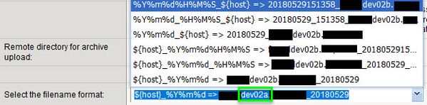

@PhillyPDXmike, As long as you use the ${host} variable in the file name iApp setting (this is included in the default file name setting) it will generate archives with unique names per device (regardless of clustering). Are there other settings you are hoping to set independently?
","body@stripHtml({\"removeProcessingText\":false,\"removeSpoilerMarkup\":false,\"removeTocMarkup\":false,\"truncateLength\":200})@stringLength":"203","kudosSumWeight":0,"repliesCount":0,"postTime":"2018-05-29T15:12:17.000-07:00","lastPublishTime":"2018-05-29T15:12:17.000-07:00","metrics":{"__typename":"MessageMetrics","views":8941},"visibilityScope":"PUBLIC","placeholder":false,"originalMessageForPlaceholder":null,"entityType":"TKB_REPLY","eventPath":"category:CrowdSRC/community:zihoc95639board:codeshare/message:288311/message:288322","replies":{"__typename":"MessageConnection","pageInfo":{"__typename":"PageInfo","hasNextPage":false,"endCursor":null,"hasPreviousPage":false,"startCursor":null},"edges":[]},"customFields":[],"attachments":{"__typename":"AttachmentConnection","edges":[],"pageInfo":{"__typename":"PageInfo","hasNextPage":false,"endCursor":null,"hasPreviousPage":false,"startCursor":null}}},"AssociatedImage:{\"url\":\"https://community.f5.com/t5/s/zihoc95639/images/cmstNDEtSzFzVEth\"}":{"__typename":"AssociatedImage","url":"https://community.f5.com/t5/s/zihoc95639/images/cmstNDEtSzFzVEth","height":0,"width":0,"mimeType":"image/svg+xml"},"Rank:rank:41":{"__typename":"Rank","id":"rank:41","position":18,"name":"Nimbostratus","color":"CCCCCC","icon":{"__ref":"AssociatedImage:{\"url\":\"https://community.f5.com/t5/s/zihoc95639/images/cmstNDEtSzFzVEth\"}"},"rankStyle":"FILLED"},"User:user:185392":{"__typename":"User","id":"user:185392","uid":185392,"login":"PhillyPDXmike_1","biography":null,"registrationData":{"__typename":"RegistrationData","status":null,"registrationTime":"2019-05-04T20:34:29.000-07:00"},"deleted":false,"email":"","avatar":{"__typename":"UserAvatar","url":"https://community.f5.com/t5/s/zihoc95639/m_assets/avatars/default/avatar-8.svg?time=0"},"rank":{"__ref":"Rank:rank:41"},"entityType":"USER","eventPath":"community:zihoc95639/user:185392"},"ModerationData:moderation_data:288323":{"__typename":"ModerationData","id":"moderation_data:288323","status":"APPROVED","rejectReason":null,"isReportedAbuse":false,"rejectUser":null,"rejectTime":null,"rejectActorType":null},"TkbReplyMessage:message:288323":{"__typename":"TkbReplyMessage","author":{"__ref":"User:user:185392"},"id":"message:288323","revisionNum":1,"uid":288323,"depth":1,"hasGivenKudo":false,"subscribed":false,"board":{"__ref":"Tkb:board:codeshare"},"parent":{"__ref":"TkbTopicMessage:message:288311"},"conversation":{"__ref":"Conversation:conversation:288311"},"subject":"Re: F5 iApp Automated Backup","moderationData":{"__ref":"ModerationData:moderation_data:288323"},"body":"
@tabernarious, Thanks for the quick response!! I am using version 3.1.2 of the iApp and can confirm that the backup worked on both the active and standby units after I copied the public/private key from the active to the standby, edited the hostname in the public key (/root/.ssh/id_rsa.pub) on the standby, then added that public key to my sftp server's authorized_keys file. \n
\n
My initial question was prompted from a cosmetic situation where the sample output for the \"Select the filename format > Destination Parameters\" setting carried over from the active appliance (dev02a) to the standby appliance (dev02b).\n
\n
Your question: \"Are there other settings you are hoping to set independently?\"\nSince the UCS backup is specific to each appliance, it'd be nice to somehow have device independence within the iApp which is probably more of an F5 iApp software architecture thing than anything to do with this specific iApp. What are your thoughts?

Hello, I a using v3.1.3. When I attempt to implement the script using FTP for remote copy, I receive the following error.
\n
script did not successfully complete: (can't read \"::destination_parameters__pruning_mode\": no such variable\nwhile executing\n\"if { $::destination_parameters__pruning_mode eq \"Only Prune iApp-Generated Archives\" } {\nset pruning_suffix $::destination_par...\"\ninvoked from within\n\"if { $freq != \"Disable\" } {\nEnsure a default $filename_format is set\nif { $::destination_parameters__filenam...\" line:44)\n
\n\n
I am trying to understand the reason for this error. When I choose the \"Select the Filename Format\" drop-down, I am selecting an option that does include ${host}. Am using code 11.6.1 HF2 on my box. I saw keithhubb post and resolution but would like to understand the reason for the
text
error before I implement on prod boxes. Thank you.
","body@stripHtml({\"removeProcessingText\":false,\"removeSpoilerMarkup\":false,\"removeTocMarkup\":false,\"truncateLength\":200})@stringLength":"203","kudosSumWeight":0,"repliesCount":0,"postTime":"2018-06-04T05:50:10.000-07:00","lastPublishTime":"2023-06-05T13:03:43.050-07:00","metrics":{"__typename":"MessageMetrics","views":8937},"visibilityScope":"PUBLIC","placeholder":false,"originalMessageForPlaceholder":null,"entityType":"TKB_REPLY","eventPath":"category:CrowdSRC/community:zihoc95639board:codeshare/message:288311/message:288331","replies":{"__typename":"MessageConnection","pageInfo":{"__typename":"PageInfo","hasNextPage":false,"endCursor":null,"hasPreviousPage":false,"startCursor":null},"edges":[]},"customFields":[],"attachments":{"__typename":"AttachmentConnection","edges":[],"pageInfo":{"__typename":"PageInfo","hasNextPage":false,"endCursor":null,"hasPreviousPage":false,"startCursor":null}}},"CachedAsset:text:en_US-components/messages/MessageSubject-1743097580000":{"__typename":"CachedAsset","id":"text:en_US-components/messages/MessageSubject-1743097580000","value":{"noSubject":"(no subject)"},"localOverride":false},"CachedAsset:text:en_US-components/messages/MessageBody-1743097580000":{"__typename":"CachedAsset","id":"text:en_US-components/messages/MessageBody-1743097580000","value":{"showMessageBody":"Show More","mentionsErrorTitle":"{mentionsType, select, board {Board} user {User} message {Message} other {}} No Longer Available","mentionsErrorMessage":"The {mentionsType} you are trying to view has been removed from the community.","videoProcessing":"Video is being processed. Please try again in a few minutes.","bannerTitle":"Video provider requires cookies to play the video. Accept to continue or {url} it directly on the provider's site.","buttonTitle":"Accept","urlText":"watch"},"localOverride":false},"CachedAsset:text:en_US-components/messages/MessageCustomFields-1743097580000":{"__typename":"CachedAsset","id":"text:en_US-components/messages/MessageCustomFields-1743097580000","value":{"CustomField.default.label":"Value of {name}"},"localOverride":false},"CachedAsset:text:en_US-components/messages/MessageRevision-1743097580000":{"__typename":"CachedAsset","id":"text:en_US-components/messages/MessageRevision-1743097580000","value":{"lastUpdatedDatePublished":"{publishCount, plural, one{Published} other{Updated}} {date}","lastUpdatedDateDraft":"Created {date}","version":"Version {major}.{minor}"},"localOverride":false},"CachedAsset:text:en_US-components/messages/MessageReplyButton-1743097580000":{"__typename":"CachedAsset","id":"text:en_US-components/messages/MessageReplyButton-1743097580000","value":{"repliesCount":"{count}","title":"Reply","title@board:BLOG@message:root":"Comment","title@board:TKB@message:root":"Comment","title@board:IDEA@message:root":"Comment","title@board:OCCASION@message:root":"Comment"},"localOverride":false},"CachedAsset:text:en_US-components/messages/MessageAuthorBio-1743097580000":{"__typename":"CachedAsset","id":"text:en_US-components/messages/MessageAuthorBio-1743097580000","value":{"sendMessage":"Send Message","actionMessage":"Follow this blog board to get notified when there's new activity","coAuthor":"CO-PUBLISHER","contributor":"CONTRIBUTOR","userProfile":"View Profile","iconlink":"Go to {name} {type}"},"localOverride":false},"CachedAsset:text:en_US-components/guides/GuideBottomNavigation-1743097580000":{"__typename":"CachedAsset","id":"text:en_US-components/guides/GuideBottomNavigation-1743097580000","value":{"nav.label":"Previous/Next Page","nav.previous":"Previous","nav.next":"Next"},"localOverride":false},"CachedAsset:text:en_US-components/users/UserLink-1743097580000":{"__typename":"CachedAsset","id":"text:en_US-components/users/UserLink-1743097580000","value":{"authorName":"View Profile: {author}","anonymous":"Anonymous"},"localOverride":false},"CachedAsset:text:en_US-shared/client/components/users/UserRank-1743097580000":{"__typename":"CachedAsset","id":"text:en_US-shared/client/components/users/UserRank-1743097580000","value":{"rankName":"{rankName}","userRank":"Author rank {rankName}"},"localOverride":false},"CachedAsset:text:en_US-components/messages/MessageTime-1743097580000":{"__typename":"CachedAsset","id":"text:en_US-components/messages/MessageTime-1743097580000","value":{"postTime":"Published: {time}","lastPublishTime":"Last Update: {time}","conversation.lastPostingActivityTime":"Last posting activity time: {time}","conversation.lastPostTime":"Last post time: {time}","moderationData.rejectTime":"Rejected time: {time}"},"localOverride":false},"CachedAsset:text:en_US-shared/client/components/common/Pager/PagerLoadMorePreviousNextLinkable-1743097580000":{"__typename":"CachedAsset","id":"text:en_US-shared/client/components/common/Pager/PagerLoadMorePreviousNextLinkable-1743097580000","value":{"loadMore":"Show More"},"localOverride":false},"CachedAsset:text:en_US-components/customComponent/CustomComponent-1743097580000":{"__typename":"CachedAsset","id":"text:en_US-components/customComponent/CustomComponent-1743097580000","value":{"errorMessage":"Error rendering component id: {customComponentId}","bannerTitle":"Video provider requires cookies to play the video. Accept to continue or {url} it directly on the provider's site.","buttonTitle":"Accept","urlText":"watch"},"localOverride":false},"CachedAsset:text:en_US-shared/client/components/users/UserAvatar-1743097580000":{"__typename":"CachedAsset","id":"text:en_US-shared/client/components/users/UserAvatar-1743097580000","value":{"altText":"{login}'s avatar","altTextGeneric":"User's avatar"},"localOverride":false},"CachedAsset:text:en_US-shared/client/components/ranks/UserRankLabel-1743097580000":{"__typename":"CachedAsset","id":"text:en_US-shared/client/components/ranks/UserRankLabel-1743097580000","value":{"altTitle":"Icon for {rankName} rank"},"localOverride":false},"CachedAsset:text:en_US-components/users/UserRegistrationDate-1743097580000":{"__typename":"CachedAsset","id":"text:en_US-components/users/UserRegistrationDate-1743097580000","value":{"noPrefix":"{date}","withPrefix":"Joined {date}"},"localOverride":false},"CachedAsset:text:en_US-components/tags/TagView/TagViewChip-1743097580000":{"__typename":"CachedAsset","id":"text:en_US-components/tags/TagView/TagViewChip-1743097580000","value":{"tagLabelName":"Tag name {tagName}"},"localOverride":false}}}},"page":"/kbs/TkbMessagePage/TkbMessagePage","query":{"after":"MjUuMnwyLjF8aXwxMHwzOToxfGludCwyODgzMTIsMjg4MzIx","boardId":"codeshare","messageSubject":"f5-iapp-automated-backup","messageId":"288311"},"buildId":"q_bLpq2mflH0BeZigxpj6","runtimeConfig":{"buildInformationVisible":false,"logLevelApp":"info","logLevelMetrics":"info","openTelemetryClientEnabled":false,"openTelemetryConfigName":"f5","openTelemetryServiceVersion":"25.2.0","openTelemetryUniverse":"prod","openTelemetryCollector":"http://localhost:4318","openTelemetryRouteChangeAllowedTime":"5000","apolloDevToolsEnabled":false,"inboxMuteWipFeatureEnabled":false},"isFallback":false,"isExperimentalCompile":false,"dynamicIds":["./components/customComponent/CustomComponent/CustomComponent.tsx","./components/community/Navbar/NavbarWidget.tsx","./components/community/Breadcrumb/BreadcrumbWidget.tsx","./components/tkbs/TkbArticleWidget/TkbArticleWidget.tsx","./components/messages/MessageView/MessageViewStandard/MessageViewStandard.tsx","./components/messages/ThreadedReplyList/ThreadedReplyList.tsx","./components/customComponent/CustomComponentContent/TemplateContent.tsx","../shared/client/components/common/List/UnstyledList/UnstyledList.tsx","./components/messages/MessageView/MessageView.tsx","../shared/client/components/common/Pager/PagerLoadMorePreviousNextLinkable/PagerLoadMorePreviousNextLinkable.tsx","./components/customComponent/CustomComponentContent/HtmlContent.tsx","./components/customComponent/CustomComponentContent/CustomComponentScripts.tsx","../shared/client/components/common/List/UnwrappedList/UnwrappedList.tsx","./components/tags/TagView/TagView.tsx","./components/tags/TagView/TagViewChip/TagViewChip.tsx"],"appGip":true,"scriptLoader":[]}
