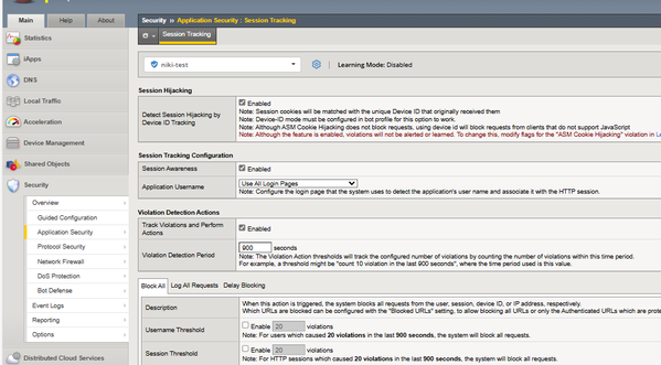

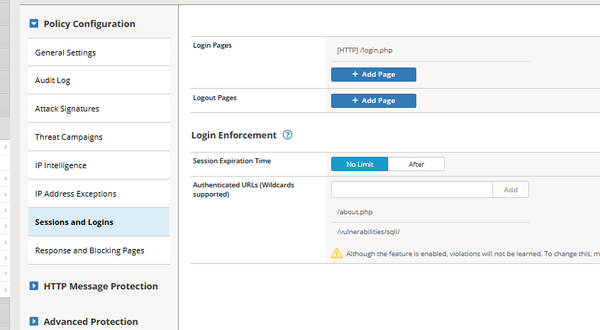

  • Configure a login page and optionally login enforcement (if " /about.php " is not blocked by the origin server to not be accessible before login this is a needed step!)
  • Enable session tracking  by login page

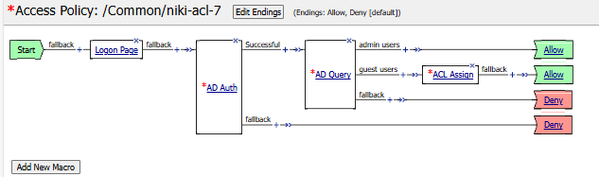

If you want to control access to URLs based on AD groups I suggest seeing the F5 APM/Acess module that will take of the authentication and with Layer 7 ACL each AD group could be limited what it has access to. APM and AWAF can work together as with layered virtual server AWAF can be before the APM as by default is after it and then to get the username you need to use the login page feature and not "Use APM username and Session ID" feature in the AWAF policy.
Example APM profile of type LTM+APM and the APM policy for anyone interested where the APM uses AD to authenticate the users and query for group data and the members for of the guest group have an ACL assigned that limits their access 😜
