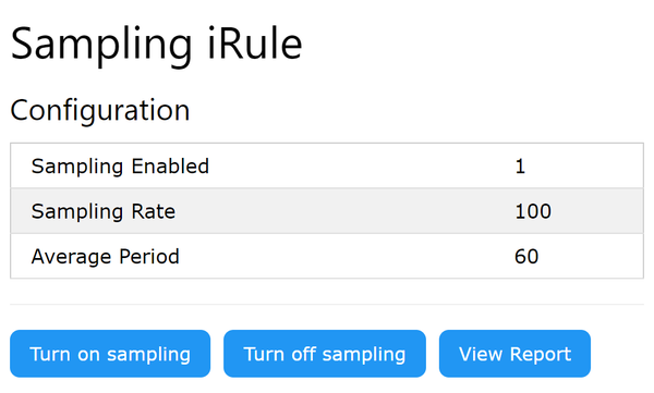

A control menu is available for tuning sampling on and off, sampling rate is varied according to CPU rate so this should be safe to use when under attack.

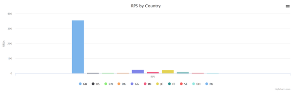

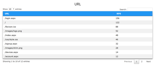

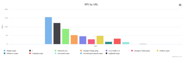

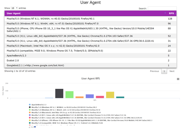

The report shows RPS based on IP, URL, Country and User Agent and shows both tables and graphs. Tables allow searching, paging and limiting number of entries. Graphs can be exported in different formats eg PNG, JPG, SVG, PDF etc.

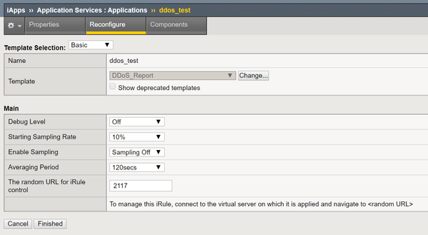

Install the iApp and run it to set variables and create the iRule, or add the iRule and set the variables.
Navigate to the virtual server on which it is applied and go to the URL as specified in the random variable eg https://1.2.3.4/6123. This will show the menu to turn sampling on or off and view the report.
