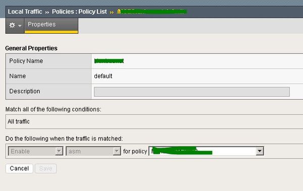

- Abed_AL-R
Cirrostratus
Ö˛@Patrik I noticed something on the report. It is not showing all the Virtual Servers that has ASM policy enabled on them. When the ASM policy enabled this way , there is no problem and the bigip report is showing them: But when it is enabled this way it is not showing in the bigip report: At the second way you can configure the asm policy at the virtual server policies section:
Hi Abed
Thank you for the report, I will submit a feature request for this.
Kind regards, Patrik
