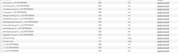

Hi Patrik,
i'm facing the same issue like Luc After the report was generated without any errors I'm just getting a blank page after the loading screen. Attached is also a screenshot where you can see that all json files are loaded with a http ok (200), but after that nothing happend. All the files were replaced with them from your provided zip file.
Any idea about this?
Thanks, Christoph

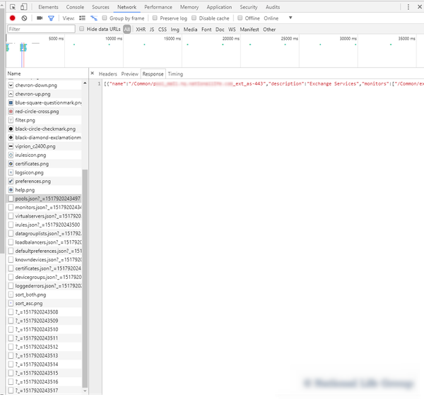

- Luc__184828
Hey Patrik!
We're your testers so never apologize :) You provide better support than most companies lol.
I may be on to something - the response from my json files look different. knowndevices.json formats like your screenshot, but the rest of them are formatting on a single line as per the screenshot below
