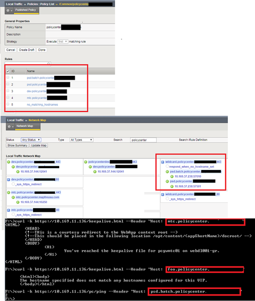

When adding rule to policy, associated pools are not displayed on the Network Map
I'm trying to consolidate some of our VIPs and use policies to route the requests based on host headers.
This all works.
But when I add new rules to the policy, the pools associated with the new rules don't display on the Network Map, only (it seems) the pools with the rules when I first created the policy.
I've refreshed, tried Chrome Incognito, and synchronized the F5s and the other F5 even fails to display the new rules. Not the end of the world, but does make troubleshooting a little more complicated when the GUI doesn't display as expected.
Thanks in advance, Matt

Hello,
Just for information I tested your Use case in my labs (version 12.1.2) and i don't encounter this behaviour...
What version are you in?
Regards.
- Matt_Kivela
BIG-IP 12.1.3 Build 0.0.378 Final

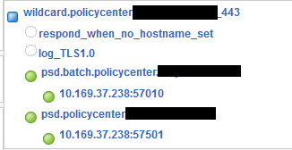

Oddly this morning I rolled out an additional iRule to log who is still using TLS 1.0, and the new iRule does show up:
- youssef1
Cumulonimbus
the irules must indeed be displayed, and all the pools that you have specified in your ltm policy too. Pool that you specify your irules don't show up...
regards
- Matt_Kivela
Resolved: Biological Interface Problem.
I was forwarding direct to a virtual server (with the same name as it's associated pool).
Once this was changed to pool and the policy re-published behavior is as expected.
