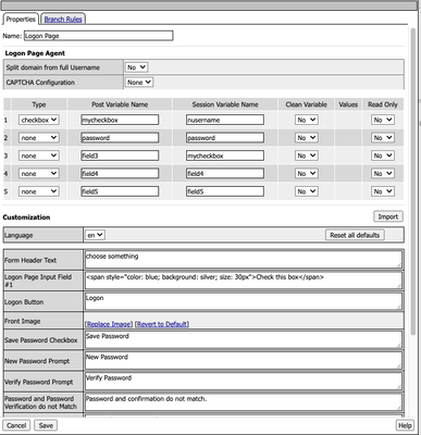

In Standard customization, you can put any code directly into any of the customization boxes. In Modern customization you can't. So for, say a logon page, you can put whatever code you want directly into the logon page fields, like this example that uses a span tag to apply CSS attributes to the input field:
Then you end up with this:

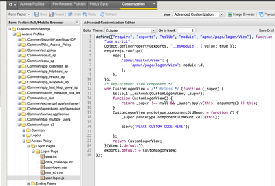

With "Modern" customization, it's a little harder because you can't just place arbitrary code into those boxes. You have to apply styles into the user stylesheet and code into the user code area. Here's what that looks like in the UI, using the example doc'd here:
With this method, you can simply execute javascript code to directly manipulate the DOM with vanilla JS or use React-style JS.
