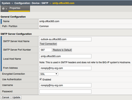

Jul 11, 2017Using STARTTLS in System | Configuration : Device : SMTP
Looking at the configuration options, it seems that STARTTLS is not supported, only implicit encryption is supported (generally on port 465). This is going to sound a bit goofy, but despite the notes...
Sam_Hall
Jul 13, 2017It seems STARTTLS is not the issue, STARTTLS works just fine despite the lack of documentation. Our production LTM is refusing to send credentials before trying to send the email. For that issue I'm opening a support case.
