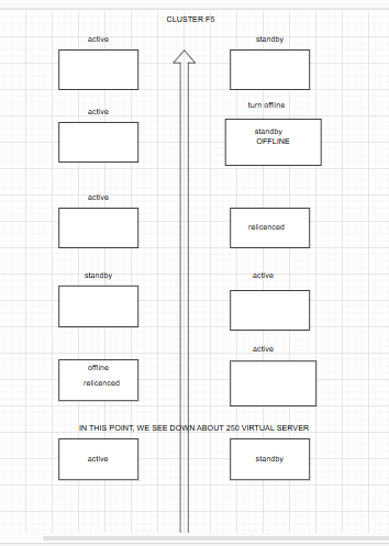

Hi whisperer how r u?
we have a solution active-standby for 2 device
we need relicenced both devices.
into the process, turn off the device standby of cluster.
After we turn on active the standby device and relicence the active device.
after relicenced the active device.In this process, we see down about 250 virtual server down with the message into the pool with :" Node address service checking is enabled, but result is not available yet"
is this normal?
the MAC masquerade solution this?
I was confused with the explanation, I leave a photo so that it is better understood
thx!
