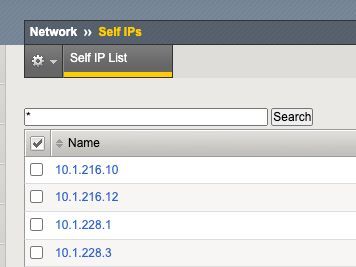

you need to configure ( SNAT Auto map on Virtual server setting ( 10.1.216.113 ) ) Automap is configured for this VIP and all VIPS in the 10.1.216.x network(VIP range)
devices in the 10.1.228.x network are unable to access devices in the 10.1.216.x range. The F5 is the default gateway.
so for the traffic flow, when ServerA sends the traffic 10.1.216.113 it will got the F5, the same F5 where the VIP resides. The VIP is configured with Automap so when the servers in the VIP pool respnd it shoud go back through the F5 and not out an external router
The F5 itself can ping the server from the 10.1.228.3 address
config # ping -I 10.1.228.3 10.1.216.113
PING 10.1.216.113 (10.1.216.113) from 10.1.228.3 : 56(84) bytes of data.
64 bytes from 10.1.216.113: icmp_seq=1 ttl=255 time=0.197 ms
64 bytes from 10.1.216.113: icmp_seq=2 ttl=255 time=0.285 ms
but other devices in that same network are unable to access any network services in the 10.1.216.x network. They are able to access everything on the network out side of 10.1.216.x
