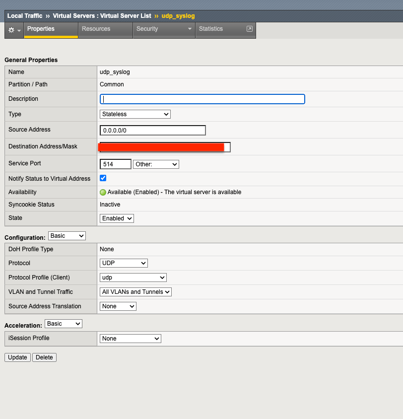

Hi Team,
We have deployed partner solution https://aws.amazon.com/solutions/partners/f5-big-ip-ve/ in AWS and HA mode has come up as expected, we can access management UI and configure our backend. However, we are unable to see traffic being sent from BIGIP to our syslog server backend.
We would like to use BIG IP as TCP/UDP HA load balancer and send traffic to our backend (syslog servers) which sends syslogs to Kibana.
Client request : [ec2-user@ip-10-0-xx-xx ~]$ while date "+INFO Syslog check for F5 BIGIP on HA mode %T" | logger -s -p user.info -n <VIP_Configured_in_BIGIP> -P 514 ; do sleep 1; done
Client --> [udp protocol 514] --> BIGIP (UDP virtual host has been created) --> syslog server (listening on 5514 port)
In kibana, we can see BIG IP syslog however, my test requests are not being sent from BIG IP to syslog server (nsg-agent)
What are we missing the configuration, we are assuming the HA configuration from https://aws-quickstart.github.io/quickstart-f5-big-ip-virtual-edition-ha/ should be working

  • Hello prajith_nsg , I see that you're using a Stateless virtual server. Port translation setting is not supported and is known to not work as expected if enabled on the stateless virtual server. (Check this KB for reference)
    You can run this command to display the connection table and confirm if port translation is happening or not while the connection is active
    tmsh show /sys connection cs-client-addr <your ec2-user client address 10-0-xx-xx>
    tmsh show /sys connection cs-client-addr 10.0.113.100

    If you need port translation to be effective, you should run a different type of virtual server -- fastL4 should work IMO.
    If it's not mandatory, you can try changing VS port to 5514 and see if client test is being forwarded as intended.

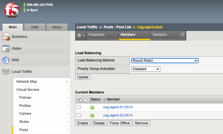

      Hi CA_Valli, Thank you so much for taking time to respond.
      I have changed the virtual server type to use fastL4, attached is the screenshot of configuration.
      From my basiton host,  I am able to reach bigIP on VIP address (10.0.10.101) on port 5514 as expected.
