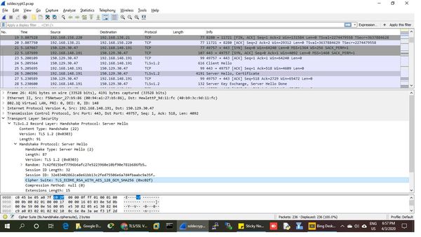

To test Ciphers you can use Wireshark to check the "Server Hello" as below to know F5 selected which ciphers from client cipher list negotiation or you can use a command in as below.
[root@lb2:Standby:In Sync] config # openssl s_client -cipher 'ECDHE-RSA-AES256-GCM-SHA384' -connect 192.168.148.184:443

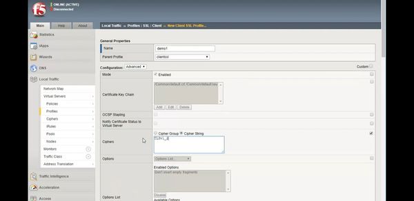

Cipher suites are configured per SSL Profiles(Client/Server), you need to type "TLSv1_2" in cipher strings as seen below to only support TLSv1_2 ciphers.
You can also check via CLI by typing command to check TLSv1.2 support ciphers only as below.
[root@lb2:Standby:In Sync] config # tmm --clientcipher TLSv1_2
