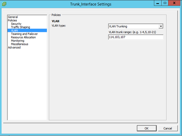

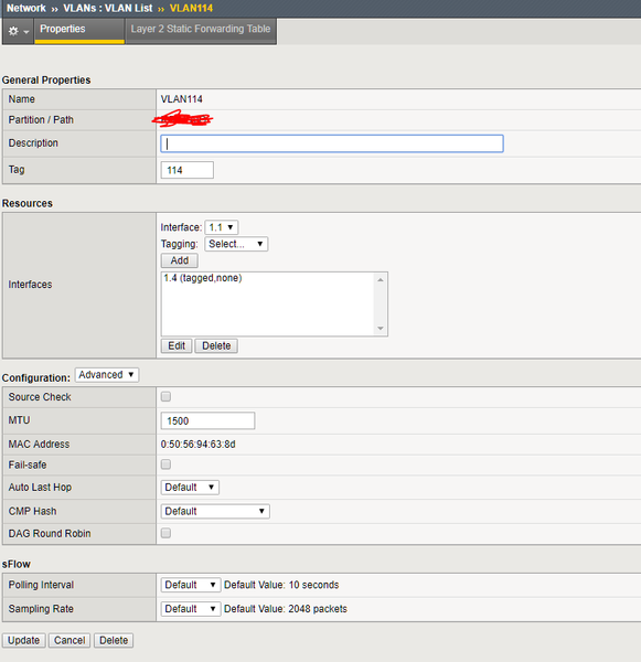

It looks like I hit an issue where my newly created tagged interface doesn't pass any traffic. I attached vswitch config showing the portgroup in a trunk mode allowing several vlans. On the BIG-IP I configured new vlan114 and added the interface as 'tagged'. I don't know why it shows (tagged,none) in the interfaces section?
I also created Self IPs on both HA units with IPs from Vlan114, but they can't ping each other.

Thanks. I'm on 11.6 and it seems that it's not affected according to 'applies to' lists.
Also I'm not sure what this workaround means? I thought I already had VLAN tagging configured at the hypervisor or does it mean something else?
Workaround
To work around this issue, you can configure VLAN tagging at the hypervisor.

First of (tagged,none) display seems to be normal. by defaul tag-mode is set to none. however When i create my vlan using tmsh like this:
create net vlan test tag 111 interfaces add { 1.5 { tagged tag-mode none } }
(tagged,none) is not display in my GUI, just seen Tagged.
