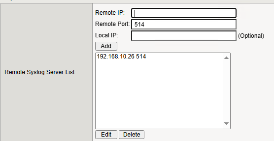

  • Hi,
    I did the following as described above:
    # modify /sys syslog include "destination remote-server {tcp(192.168.10.26 port (514));};"
    Checking the configuration:
    # list /sys syslog
    sys syslog {
    I added and deleted the following:
    Added the configuration above (GUI), list /sys syslog shows:
    # list /sys syslog
    sys syslog {
    remote-servers {
    remotesyslog1 {
    host 192.168.10.26
    Adding Remote Syslog Server with GUI sends UDP packets.
    Removing it, no packets are send to the syslog-server.
    This was seen with tcpdump on the F5 and the firewall between the F5 Big IP and the syslog-server.
    What do I missing, to make it working?
    Thanks in advance
    Christian
