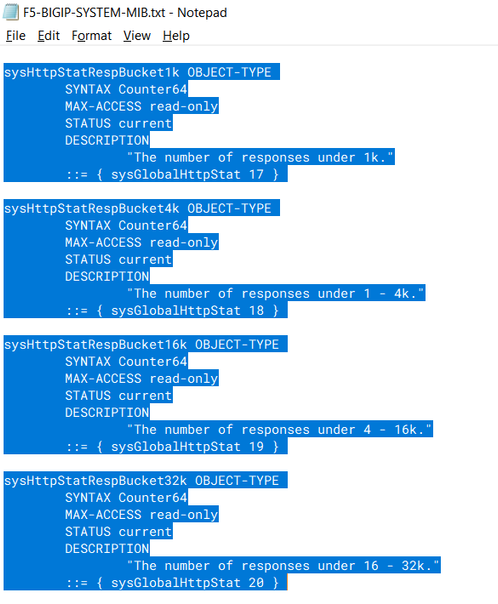

Hi,
I would like to get information about few of the exposed SNMP metrics which description is very unclear...
sysHttpStatRespBucket1k with oid 1.3.6.1.4.1.3375.2.1.1.2.4.17
sysHttpStatRespBucket4k with oid 1.3.6.1.4.1.3375.2.1.1.2.4.18
If we take sysHttpStatRespBucket1k, I found following description "The number of responses under 1k." but are we talking of a HTTP response size or a duration?
Thanks for light anyone could provide on this topic.
  • it is about the size.
    the unit type is byte.
    as comparison, the oid for pool member queue length explicitly mentions millisecond
