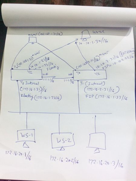

This is the scenario, all ip address are of /16 subnet mask
I am using vertual machines on my vmware platform, version is 11.3
First box configuration
Vertual server ip 10.10.1.100/16
vlan Internal 172.16.1.31/16 Floating 172.16.1.33/16 Vlan external 10.10.1.31/16 Floating 10.10.1.33/16
VLAN HA 1.1.1.1/16
Second box configuration
vlan Internal 172.16.2.31/16 Floating 172.16.1.33/16 Vlan external 10.10.2.31/16 Floating 10.10.1.33/16
VLAN HA 1.1.1.2/16
All steps including Ha are configured with setup utility be it creating trust, setting device group and traffic group
after configuring I found that ha is good because one is showing active and other is standby but below it the sync status is disconnected
when checked sync status from device group i found one device says "Awaiting initial sync" and other says Disconnected also on other box this is reverse
