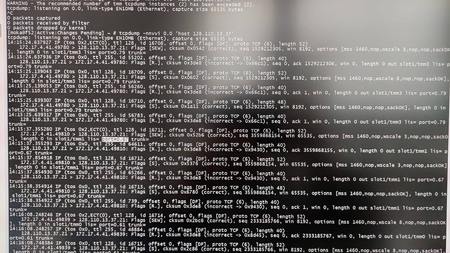

Strange phenomenon seen in the tcpdump
Hi Sanyang,
The command you are using tcpdump -nnvvi 0.0 is Capturing internal TMM information with tcpdump.

It is the -nn that adds the TMM info. The following I think should work and not insert tmm info:
tcpdump -i external host 128.110.13.37 -w /path/ -s 0 -vv"
Instead of using any interface 0.0
tcpdump -nnvvi 0.0
you should use the specific interface of your concern.
tcpdump -nnvvi <interface_number>
It's the nnnp when joined with interface or vlan provides high level of tmm info.
Ex: tcpdump -nni 0.0:nnnp....
nnnp - Low, medium, High tmm details in the packet capture with specific traffic flow between peers.
