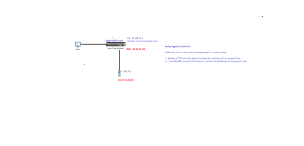

Hi Team ,
We have an issue accessing the url test-dev-01.example.com via F5 VIP but direct access to server one-test-dev.trading.net is working fine .
Error : "connection reset"
Please find the vip configuration details below…
Please advice if anyone has faced similar issues or possible root cause …
thank you.
VIP : 10.128.10.5
Url : test-dev-01.example.com
port : 443
VIP has http profile , Client SSL profile , Server SSL profile , no default pool ( redirection to pool via policy ) , no persistence profiles.
Policy/Irule:
HTTP Host host is 'test-dev-01.example.com' at request time.
1. Replace HTTP Host with value 'one-test-dev.trading.net' at request time.
2. Forward traffic to pool '/Common/P_one-test-dev.trading.net' at request time.
SSL handshake error message : 100.19.10.10 is backend server 10.10.10.250 is SNAT Ip
