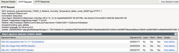

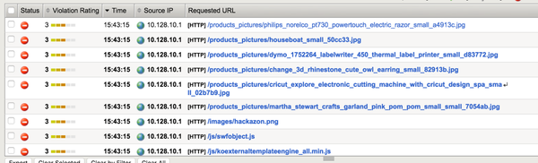

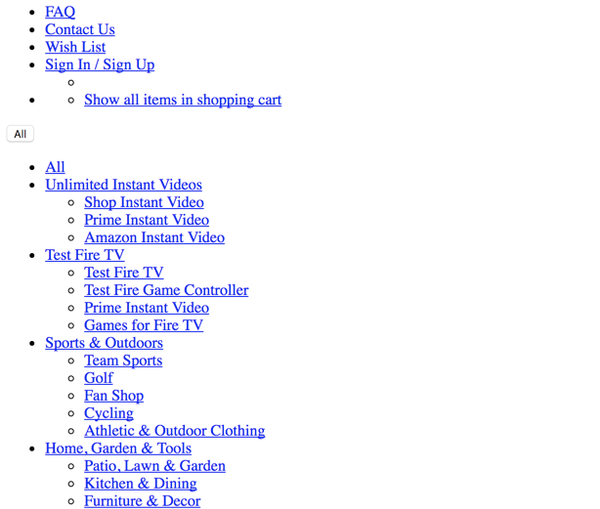

When a test request is sent like so - or 1=1 union select a couple SQl signatures are triggered but no response page is presented. Instead the ASM treats the request as a referer and all jpgs, js and other image files are then blocked. The page displayed is just text:
If I use a manually created policy with all default settings and no change any settings, the index.php page is blocked and no additional resources like jpgs, js etc are blocked. The response page is displayed. I then edit the same policy and make it so only SQL Injection is enabled and the behavior of being a referer happens again.

It looks to me like the primary request is not detected and blocked.
The page renders HTML, but all subsequent linked requests for CSS and Images include the referrer - which does trigger the signatures and is blocked.
Turn on logging for all requests - you should see what is happening with the first request.

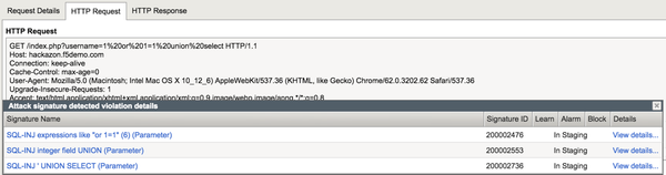

Good call with the all requests. I set the policy to log all requests and saw the index.php log with attack signatures showing in staging??
Staging is disabled on this policy and when I look at the specific signatures they are not in staging:
If I look at where the GET in a referer the signatures are not in staging. Of course these are the (Header) type signature versus (Parameter) but why would one be in staging versus the other?
Again all that is enabled is the SQL Injection Signature set and none of them show in staging. Policy building is manual.

Check the signature settings for the wildcard parameter. There may be some implied staging setting there for non-specified parameters. Then create a specific parameter and test again.
- Dave_Pisarek
Cirrus
This is now resolved. Thanks S as the staging was still on the wildcard and when disabled the issue went away. This explains the difference in the parameter sig and the header sig..
