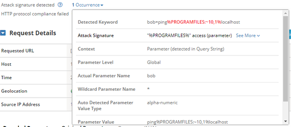

Now here’s the good news: ASM includes signatures, by default, for all of those useful Windows environment variables (and the same for many other systems, too), so if you were to try the above on a vulnerable system with the right signatures in the policy, you’d still be blocked – like this:

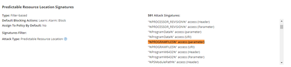

All these signatures are part of the Predictable Resource Location Signatures signature set, so you’ll want to make sure you either have all signatures of Medium or above, or at least this set assigned to your policy:
