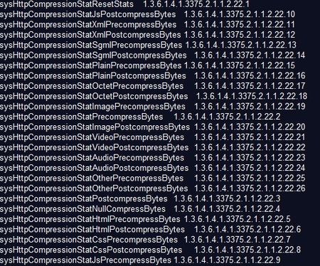

Hello,
I am looking for the Compression Ratio value MIB for SNMP. These are the MIBs I have found but still could not catch the Ratio value.
Is there anyone who knows the Compress...

Jan 08, 2015Assuming you want the ratio of post to pre... Then the ratio (post:pre) is simply calculated by dividing the PostCompressBytes by the PreCompressBytes for the appropriate type (e.g. sysHttpStatImagePostCompressBytes/sysHttpStatImagePreCompressBytes to get the compression ratio for Images..
