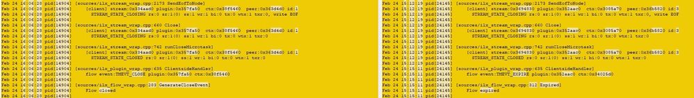

  • After further investigations I've discovered the problem lies in the closing of the ILX PLugin flow.
    I ran the same ILX Plugin code with the same transaction request with logging enabled in v14 and v16 firmware.
    In the The v14 firmware which works you can see "Flow closed" but in the v16 firwmare log you can see "Flow expired" some time after the flow should have been closed.
