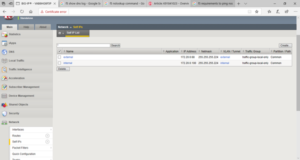

I'm setting up a new F5 in Azure with the following IPs:
internal self IP: 172.20.0.100
external self IP: 172.20.068
Both of these interfaces are displaying as UP.

  • Hi bcarreker,
    can you confirm your internal and external self IPs and netmasks ? As it is unclear why you define them in the same network if i read correctly.

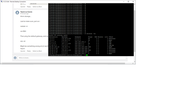

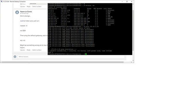

  • Hmm strange...
    Just to make sure, just run :
    netstat -nr
    via SSH

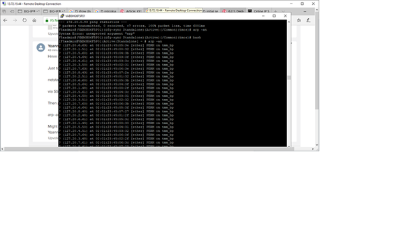

    Then ping the default gateway, and run
    arp -an
    Might be something wrong at L2, but if so might be on azure's side ?
    Yoann
  • The ARP command returned a lot. I copied the first page of it. ​I think it may be an issue with azure as well. I'm not entirely sure though.
