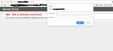

Hi David,
Are you sure that you authentication is NTLM? It could be basic also...
Can you process a capture using fiddler or F12 (devtool) in order to see how you negotiate authentication with backend NTLM, Kerb or Basic.
Additional point, can you check that URI that you set is correct (maybe you can test a wildcard /owa/* for begining). In all case I advise you to capture exchange in order to determine the right URI and the right authentication.
regards,
Additional you confirm that you set Brute "Force Protection Configuration" corectly
