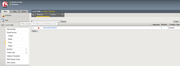

Hi ,
I am setting up a Big-Ip lab using the Big Ip LTM VE(virtual edition) 90 days trial version, I am following the Keith Barker CBT nuggets to create the lab and using his resources provided in the nuggetlab file. I have created three nodes and have added them in a pool , i have added a default http health monitor to server pool , but my pool is showing offline(Red) with a description "offline(enabled- the children pool members are down)" and my nodes are in unknown status. If i use ICMP as a health monitor , my pool and nodes becomes available(green).Below is the troubleshooting i have done.

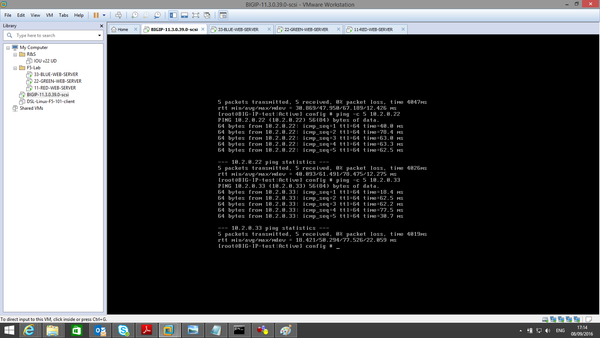

- i can ping all the three nodes from the BIg-IP command line utility.

Attached are the screen shots. Please suggest where i am wrong and what else i can check or this is a limitation in this trial version.

Pool shows "Offline (Enabled) - The children pool member(s) are down".
