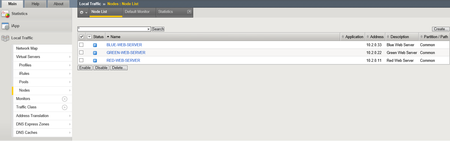

I had a similar issue, when using the 90 day trial for the CBT Nuggets lab, the Pool would show down. What my issue was the default HTTP monitor being used.
I created a new monitor under Local Traffic -> Monitors
Name http_11.3
Parent Monitor - http
Send String: GET / HTTP/1.0\r\n\r\n
Leave other options as the defaults.
Then under Local Traffic -> Pool choose the OUR-WEB-SERVER pool. In the Health Monitors section add the http_11.3 monitor and remove the http monitor, and make sure to update the configuration.
See if that works.
