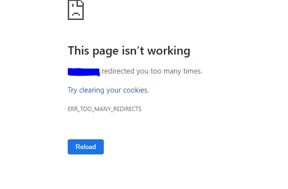

  • Thanks for the reply
    all are working except if a user add www. its giving error . For the URL as am using wildcard cert
    http://example.com or https://example.com or example.com or
     http://www.example.com or https://www.example.com
     should be redirect to https://example.com/xyz

    • Hamish's avatar
      Hamish
      If www.example.com and example.com are the same VS, then this is the source of your looped redirect. You hit the same host again (example.com) and then redirect because your HOST ends with example.com...
      You need to check the the URI is NOT /xyz already...
      e.g
      when HTTP_REQUEST {
        if {  ([HTTP::uri] begins_with "/xyz") } {
          return
        if {[string tolower [HTTP::host]] ends_with "example.com" }  {
               HTTP::redirect "https://example.com/xyz"
      Change begins_with to equals depending on what the rest of the content looks like...

  • Seems like you are having a redirect loop. Can you share your VS on config on port 80 and 443?
    list ltm virtual <virtual_server>
