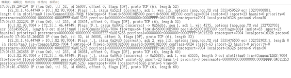

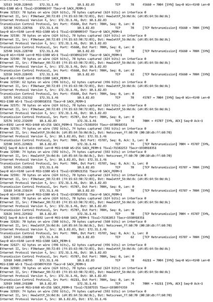

      most the service is UP, except TCP port 7004. So I don't need the scrip file. I need advice. how to adjust the parameter of the TCP profile.

  • lots of server and service work normal. only two use port 7004 has problem according the dump information - responding is not correct I tried auto-map & snat. it is not work these two server is up (green)
