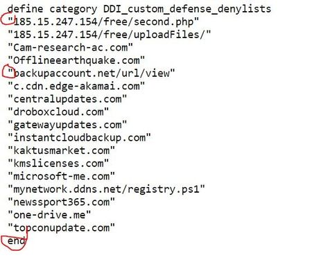

Jan 12, 2023Remove Quotation marks
Hello, I have this URL https://192.168.140.28/nonprotect/urlshare_v2.txt which displays the page in attachemtn bellow I need to remove the qoutation marks at the bigining and at the end ...

I think that you want remove quotation marks in HTTP RESPONSE event. You can use the stream feature:
https://clouddocs.f5.com/api/irules/STREAM__expression.html
regards
