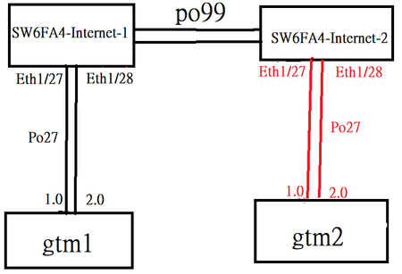

Hello Experts, I've recently encountered a strange problem where the ping node drops packets (about 10-20%) when gtm1 is active, but when gtm1 is in standby, the ping node doesn't drop any packet...

Oct 17, 2024The only thing I can glean from this setup is the trunk links between Po27 & SW6FA4-Internet1.... Could the ping traffic that's experiencing drops be hashed to a particular link in the port channel? *** Do during maintenance window *** if possible, disable one link between gtm1 & SW6FA4-Internet1. monitor ping loss, restore then disable the other link. You could have the traffic hashed onto one of the links in the port channel and its possible a bad patch.

Oct 18, 2024OK , I will try it.
Thanks.
