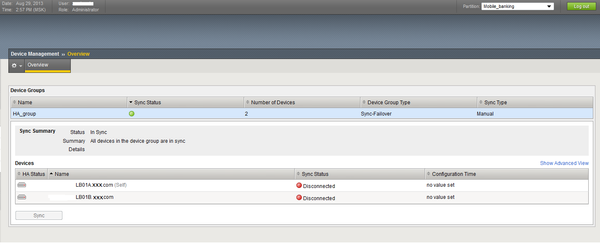

Hi, I have problem wih syncing LB cluster v11.2.1 HF6 when I try to do it from another then COmmon partition. Also in device management I see status in each partition - "Disconnected". In Common it is "In Sync". Do you have an idea what can be wrong? (I am not using mgmt IPs for configsync)

yes, I use own route domain for each partition. config-sync IP: 10.21.8.97 (Active unit), 10.21.8.98 (Standby unit) failover IP: 10.21.8.97 (Active unit), 10.21.8.98 (Standby unit)
show cm sync-status: Color green Status In Sync Summary All devices in the device group are in sync Details /Common/standbyLB.domain.com: connected (for 5884590 seconds) /Common/HA_group (In Sync): All devices in the device group are in sync /Common/device_trust_group (In Sync): All devices in the device group are in syncPlease notice that after all it is synced, because I can sync all config from Common partition. But its not possible to do Syncing from another then Common partition (and status is disconnected there) I noticed this behavior also in another our LBs, all have 11.2.1 version..

"configsync and failover ip are in default route domain/common partition, aren't they?" - yes they are in Common partition in dedicated route domain for that partition.
I compared your setup with mine and its exactly the same, also test with creating pool and configsync from the partition another then Common was working via tmsh. But web GUI still shows disconnected and accept syncing only when I am in Common partition.
