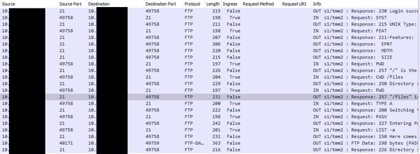

    No issues at all, see tcpdump.

      In my Wireshark capture it looks like this:
      vsftp server ----> floating self-IP >> ftp.passive.ip==<IP address of the vsftp server>
      virtual server ----> client >> ftp.passive.ip==<IP address of the F5 virtual>
      So the value for ftp.passive.ip get's updated and replaced properly.
      I tried with FileZilla and WinSCP, no special config required there either. Just works.
