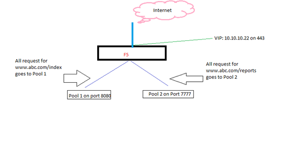

Need assistance and guidance to understand the configuration to setup a VIP on port 443 which will send traffic to 2 different Pool with different ports.
Example: VIP: 10.10.10.22 Port 443 Pool1: 1.1.1.1 and 1.1.1.2 on Port 8080 Pool2: 3.3.3.1 and 3.3.3.2 on Port 7777
Waiting for expert advice.

  • Actually to save public IP as a VIP, the solution was designed like this where we have to use 1 vip to cater multiple pools based on different URI's.
    For eg: Considering below setup:: if there is a uri and (where index is the main content for the web page hosted on one set of pool members on port 8080 and reports are the files catered from other pool member on port 7777).
    So basically when request comes for report the LTM must send that traffic to 2nd Pool and if the request comes in for the main web page LTM sends that traffic to 1st Pool.
  • P_K's avatar
    P_K
    Thanks for clarification and diagram. if i understood properly, you need to create 2 pools
    Pool_1 -> 1.1.1.1:8080 and 1.1.1.2:8080
    Pool_2 -> 3.3.3.1:777 and 3.3.3.2:7777
    Apply below iRule to your VIP and test.
    when HTTP_REQUEST {
    switch -glob [string tolower [HTTP::uri]] {
    "/index*"
    pool Pool_1
    "/reports*"
    pool Pool_2
