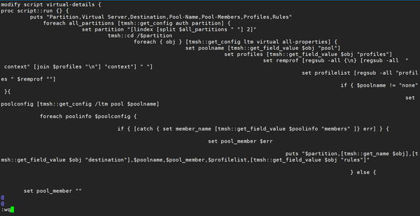

root@(awaf)(cfg-sync Standalone)(Active)(/Common)(tmos)# edit cli script virtual-detailsHere is a screenshot:
Now a vi-style editor will open you must paste from line 52 to line 88 the end of the code snippet. Verify that copy&paste worked. In my test, the proc from line 52 was not pasted, I had to type it manually.
Also exit this editor in vi-style with :wq. You will additionally be prompted whether you want to save the script.
Now run this command to verify your changes were saved.
tmsh list cli script virtual-detailsIf everything looks good, run the script. Here is a screenshot from a successful run:
- Daniel_WolfFeb 12, 2021
MVP
One more thing... this is how the script editor looks in my environment after I pasted the script. I tested on 15.1.2.
