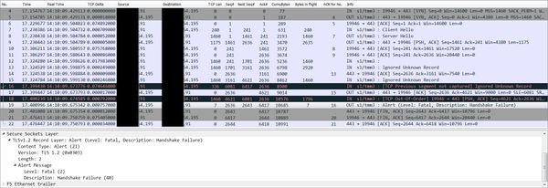

Hi Ashwin,
does this provide you more useful information? Thank you!
Ciao Stefan :)
