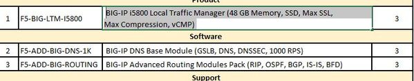

We have 2 BIG-IP i5800 box with DNS and LTM license. For a new deployment with a need of 3 vCMP guest with redundancy (failover) in two of the boxes
Can anyone help regarding resource segmentation ? We need 3guest .1 for DNS&LTM another 2 for LTM only
I am new to this VCMP if you can help me with how we start planning for deploying the boxes with configuration , it will be great Thanks in advance

    The license can be applied to vCMP host only. vCMP guests inherit license from the host. Your license need to have vCMP, DNS and LTM modules otherwise you will not be able to do what you want.
    Do you have such licence?

    Check System - Resource Provisioning, is there an option to Provision vCMP?
