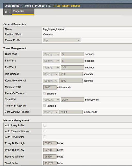

Meanwhile from TCP dump analysis output we found “tcp zero window” is getting timed out. Initially it was set to 20k Milliseconds, they increased to 60k and later increased to 300k millisecond, still test were failing in Non-Prod when LB was introduced.
x.x.33.11 is VIP IP and x.x.239.226 is OCP IP
As of now, LB is bypassed in PROD and all cycles are running smoothly. Everyone is suspecting that it's an F5 issues. We don't have any evidence to prove ourself. Is there any tuning required on F5 VIP or anything else which could solve this ?

Hi Nitesh Did you tried by using FastL4 or FastHTTP ? These will help for high performance traffic requests.
