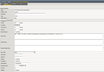

The custom https monitor that we have created does not work, before uploading the f5 version, it worked correctly, We don't know if there may be any syntax error, due to this version, or another parameter., this monitor check

    and I think you are hiting in this bug >>>  https://cdn.f5.com/product/bugtracker/ID1026781.html
    > in your send string I see \r\n\r\n so it's doubled , try to remove one  "\r\n" to make your send sring has singe "\r\n" not doubled.
    > Or try one workaround that are in the bug article which i sent above.
